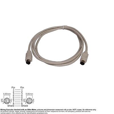

Is this the correct sort of cable required? I tried using the 8-pin to 8-pin cable that went with my Apple MIDI Interface, but that doesn't seem to work.
EDIT: Doesn't seem like it.
daanvdl
No, You will need a crosscable: https://airtalk.shop/?product=apple-modem-cable
All DIN serial cables are crossovers. The cable from the tone module should work. Strange it doesn't.
Skate323k137
I have straight thru ones but I have them clearly labelled as such.
I use the same cable for an imagewriter II, airtalk, and MIDI module; a crossover.
The straight through ones aren't for using as serial though are they? Or am I being daft 😆
I've seen straight through ones sold as serial, irritatingly. My only theory is that some samplers use it or something?
Oh, anything that uses a din cable that isn't a RS422 cable could be wired differently. But any mac serial cable should be compatible.
mdeverhart
My (flimsy) recollection is that modems used the straight through cables, consistent with the (annoying in my opinion) DTE (computer) vs. DCE (peripheral) designations. Printers and many other peripherals used crossover cables. Point-to-point LocalTalk between two Macs also can use a crossover cable.
Iesca
All is well. I acquired an Apple 590-0552-A printer cable and it works! My 2010 iMac is talking to my Macintosh Plus. :) Now, with just about 18k taking a couple minutes to transfer, there may be some kinks left to work out...
