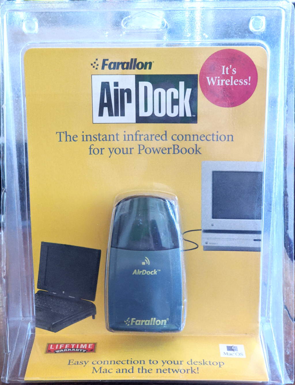

retr01
Active member
That‘s native LocalTalk speed: It takes 4.34 microseconds to transmit a single bit.
Ah. So, AirTalk is faster than AirDock? I am not sure about that. Since 230.4 kbps is the native LocalTalk transmission rate, IR used with AirDock is slower than AirTalk unless the light of sight then faster than WiFi since WiFi signals are not a line of sight but bouncing all over the place?
robin-fo
Nope, the AirTalk is definitely not faster than native LocalTalk (wired or IR)
