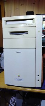

Secondly. I've just got my first ever Mac, a very lovely Power Macintosh 8100/110.
This system came with a Newer Tech MaxPowr G3 at 240MHz, and the AV video card, rather than the HPV you'd normally expect in the 110.
It's also got the maximum 264MB of RAM, so I should be pretty well kitted out, but:
How is the performance of the AV card vs. the HPV? Would the AV card limit what software and games I could run on this system? Is it worth shelling out $150 or so to get the HPV card + 4 VRAM SIMMs?
Also, the fan in the PSU is quite noisy, and I'd like to replace it with something quieter, but with the fact that there's no other active airflow, I also don't want to risk overheating. So, does anyone know the specs for that fan? CFM etc? I'm considering simply going with something fairly high end from Noctua. Do you reckon that would be enough?
Thanks in advance for any assistance :)

Nice, the 110MHz :) Never got my hands on one. What is the bus speed? 36.7MHz?
You should be able to find one much cheaper than that, but you might have to watch for a long time.
The HPVs is faster, but not a huge amount. The reason is that the HPVs are faster is that they have a 64bit wide connection to the processor, while the AV cards are only 32bit wide.
Note there are two versions of the HPV, the 8100 came with one with 2MB built in, upgradable to 4MB. They're hard to find, you have to basically look really closely to see the difference. But.... The other 1MB (Max 2MB) version is just as fast. Note the AV is fixed at 2MB VRAM.
I don't advise using a noctua. You will likely find it will be a huge amount quieter if you clean off dust and dirt, then put about 3 drops of silicone oil in the bearing.
Missed this bit - no, it wouldn't, you might have a slight reduction in frame rate, but the main thing vs. a 4MB FPV would be able to do 24bit colour at higher resolutions, mainly for photo editing sort of thing.

As a note, the 8100 case is extremely prone to falling apart. Some parts of the internal plastic are extremely brittle after all these years. I might suggest that you do as many of the things inside the machine at once as possible to avoid taking it to bits unnecessarily.
I'd be inclined personally to see if you can do what you want to do with the AV card before trying to hunt down an upgrade.
Becks79
Oh yes. It's EXTREMELY brittle. When I received it, plastic bits came drizzling out of the box it was packed in. I spent a day gluing together as much as possible. The reset and interrupt switches are missing, although the internal part they should have been part of is still there, although the clips that should hold that in place are broken, and were not in the box. I have an Amiga 1200 and multiple old PCs, but none are anywhere near as brittle as the Power Mac. I mean, I'd heard about the brittle Apple plastics, and I see that none of it was exaggerated.
The system as it sits now, looks fairly intact aside from the missing switches, although I don't think it should be too hard to fix those.
I had another look at the HPV card on eBay, and it turns out it's the 1MB version, so definitely not going for that one.
And yes, I definitely don't want to open this system up more times than I have to. I imagine a total of two more times, once for installing BlueSCSI and overhauling or replacing the fan. And once for recapping and fixing the switches.
Oh, and I miiight swap out the slow 2x CD-ROM drive for my Plextor 8x CD-R drive that is currently installed in my Pentium Pro.
3lectr1cPPC
Looks like someone swapped all the bezels out a long time ago, they’re more yellow than the rest.
And yeah, 90s plastics across the board are pretty bad. Not just apple, although they probably have the worst reputation for it. It really depends on how well built the hardware you’re dealing with is, and apple used some really thin plastics.
