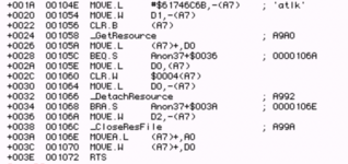

After this appears to be a load of code for the LAP Manager:
And this definitely is code, it's not just random data: there's definitely routines doing sensible things in there.
But the question is: how on earth does control get down there?
