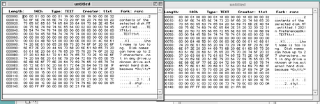

3. Using HexEdit (or any other editor that let’s you view the raw contents of the resource fork), open the raw resource fork of the original “untitled” file and the copy you made.
Observe that a chunk of the file differs in these "identical" files. (Aside: there is a lot of unrelated garbage in the first 256 bytes because whatever OS routine created this did not clear the memory buffer first. Boo! Boo!)

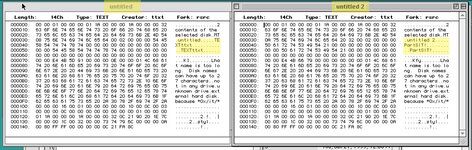

In the example above, notice that the filename and file types unexpectedly appear within the resource fork and differ between the two “duplicate” files. The second copy was created from Unstuffing and has a clue in the type/owner of “Part” and “SIT!”. It appears the information about the file itself is captured as the resource fork is being established (i.e. “Part”) – before StuffIt gives the file the final type/creator of “TEXT” “ttxt”.
