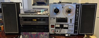

That marvelous machine puts my humble Ampex 960 to shame!...I have a feeling my adventures in floppy drive cleaning and re-lubrucation will serve me well rehabbing my latest acquisition. Yes, I jacked the Partridge Family!
If anyone has experience with this model Reel to Reel please let me know, definitely needs some love.
Of course!thanks for all your kind words and good advice! I'
This is probably due to hardened grease in the bearings. Bear in mind, though, that the capstan may not be seized, but rather the drive belt is likely broken, unless this is a three motor deck, which I doubt (three-motors are usually found in high end prosumer or studio-grade decks, whereas most lower end consumer decks usually use one motor).capstan is seized as is the tape engagement mechanism that is supposed to move up and press the tape up against the heads.
It so happens that I have an extra 8 Track player, if you're interested (if you are, PM me). It would need some restoration work, but when I tried it (like 15 years ago!), it kinda-sorta played, though with the muffled sounds so characteristic of a misaligned machine. I may even have a cartridge or two to go with it.Next I need an 8 Track!
Thank you for the invitation! Most all consumer-oriented machines were single motor, and they resorted to lots of mechanical trickery to manage fast forward, rewind and play to work all the same. The problem is, most of these mechanisms (that I know of) relied heavily on rubber idlers and belts, which is why they don't tend to age very well.And @CC_333 You are welcome anytime you find yourself in my neck of the country. And I did some more research you are correct it's a single motor unit.
