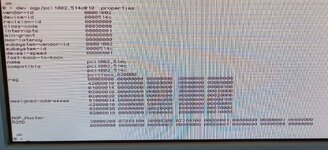

I took a few minutes to test this out before getting down to my weekend work.
I tried displaying the .properties in OF, but I'm not sure if I did it correctly; I've attached it.
I also tried adding an M25P10 and simultaneously disconnecting Vcc on the 74LVC574A, but I get the same result and the same information in both OF and Apple System Profiler.
The agp device is the pci host controller for the AGP slot. PowerPC Macs can have multiple PCI controllers each with their own PCI bus.
The AGP graphics card is probably a child device of the agp device. agp is a devalias for the pci@f0000000 device. pci0 is another devalias for the same device.
I think the AGP bus usually has only one child device but there exists some AGP cards with multiple PCI function numbers or a PCI bridge with multiple PCI device numbers.
Type dev / ls to get a list of devices.
You are looking for the pci1002,514c device. Maybe it will be agp/pci1002,514c?
Alternatively, you can use the device number agp/@D (might be something other than @D)
Alternatively, you could do a dump-device-tree to get properties for all devices.
But first, you should learn how to connect using telnet so that you can capture the output as text.
https://forums.macrumors.com/thread...l-work-in-a-beige-power-macintosh-g3.2303689/
What version of Open Firmware does your Mac have?
Hi @joevt , it's working now, I followed your steps. But, could it be that it's not reading the EEPROM but the information from the GPU? Because I've run the .properties file both with the M25C10 MOD (disconnecting Vcc on the 74LVC574A) and with the "original" EEPROM, and I get the exact same result with both. Note that both dumps were from the EEPROM with the Mac ROM.
