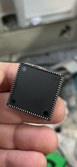

Yikes. Why did they even have the BBU out! It's not exactly a user serviceable part.
There is a chance that that level of damage has also bent pins in the socket.
You might be able to bend the pins back, but it will take a lot of care and skill.
Cheapest solution is probably a replacement working logic board. I'm not saying it isn't fixable, but if you need to buy a BBU and socjet, and then pay a professional to solder in a new socket, it will cost more than just getting a board.

It's likely that the previous mangled insertion bent the pins in the socket back, so worth checking to make sure the contacts are... in contact.
Put a straight edge down the pins and check for ones that don't stick out enough.
Check the socket, are any contacts crushed? Can they be adjusted with a careful poke?
Note even if you get it right, it is possible that the BBU being mangled like that has toasted it, or something else on the board. Just to warn you.

Sure looks a whole lot better, but I just worry the BBU itself might be toast due to the pins being shorted out or being in the wrong place before...

I have included four close-up images of the BBU socket (rotating the board as I go). I don't have a magnifying tool to assist me but it looks to be okay. Maybe. Please let me know if you see anything out of place...IMG_8522.JPEGIMG_8523.JPEGIMG_8524.JPEGIMG_8525.JPEG

The BBU is many things. It is a load of functionality that was spread through several chips in older macs done better in a single chip.
It does address decoding, clock generation and other stuff.
It is... a very bad thing to plug it in the wrong way.
BBU, short for the Bob Bailey Unit, combines a whole lot of functions which were handled by individual chips (PLA's) in earlier Macs.
One of the issues you had before with the display being garbled,, well, the BBU handles memory access for the video, so the sypmtoms make an bit more sense now seeing the state of your BBU!
