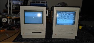

Yeah I'm in the same boat. I just finished off two SE/30 recaps, so 22 caps, with push/twist. Zero pad damage.
Conversely, may years ago I decided my very first recapping attempt would be with hot air on an Amiga A600. How hard can it be right? Yeah, I still haven't gone back to fix the legion of mistakes I made then, and the machine is basically non-functional now (hard freezes randomly after boot). It was functioning fine (albeit due a recap) prior to my ham-fisted attempt.
Here's my (2) SE/30's, newly recapped. Used the push lightly down and twist with needle nose pliers method, for both. No problems.
