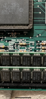

So maybe it’s an issue with the RAM. I noticed a resistor missing. Which I think is correct when upgrading to 4MB? BB795AE6-A8CE-4813-BE2D-818140DE5B8E.png

So maybe it’s an issue with the RAM. I noticed a resistor missing. Which I think is correct when upgrading to 4MB? View attachment 56145
The computer has 1MB of RAM installed, as 4x 256k SIMMs. The resistors are exactly as they should be.
