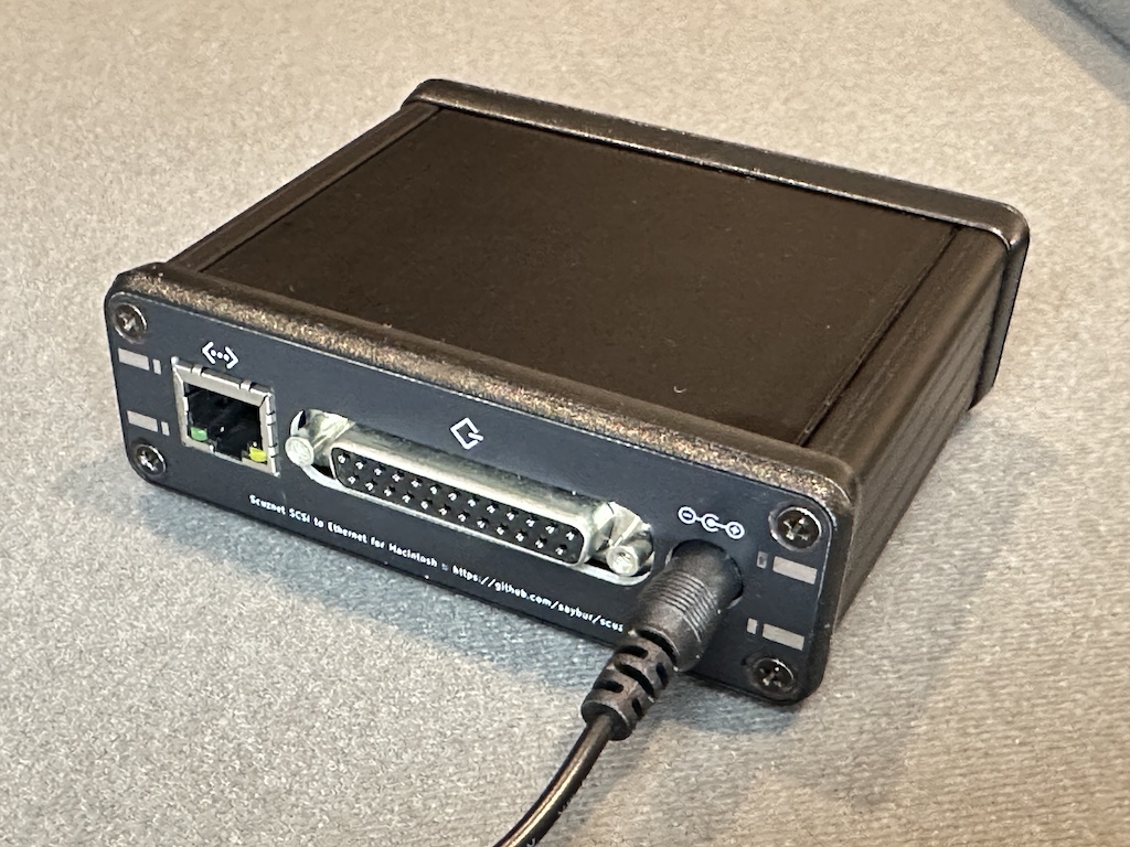

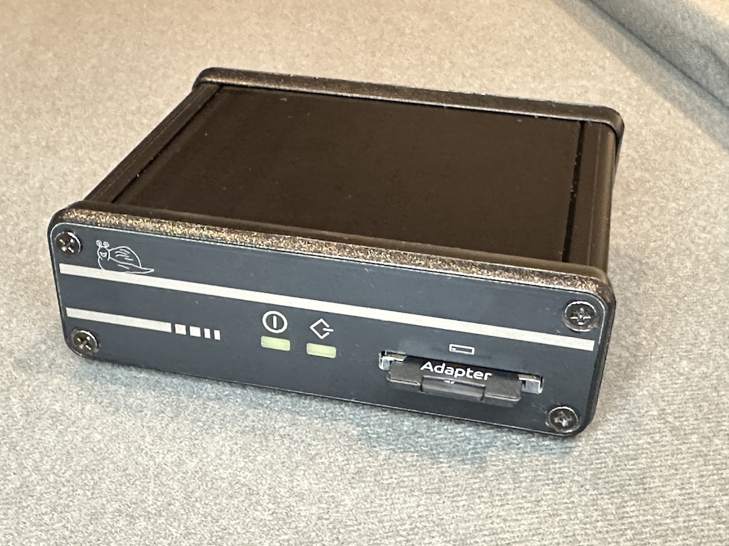

there is some updates coming in the GitHub, mostly BOM updates of obsolete components, and also FR-4 panels to use with Hammond 1455L801case. The PCB stays the same
@Chopsticks printable case is the smarter way to have a nice enclosure, but if you do not have access to a 3D printer or want an aluminium based case, here is what it looks like
Thanks to @cheesestraws for the work on panels symbols

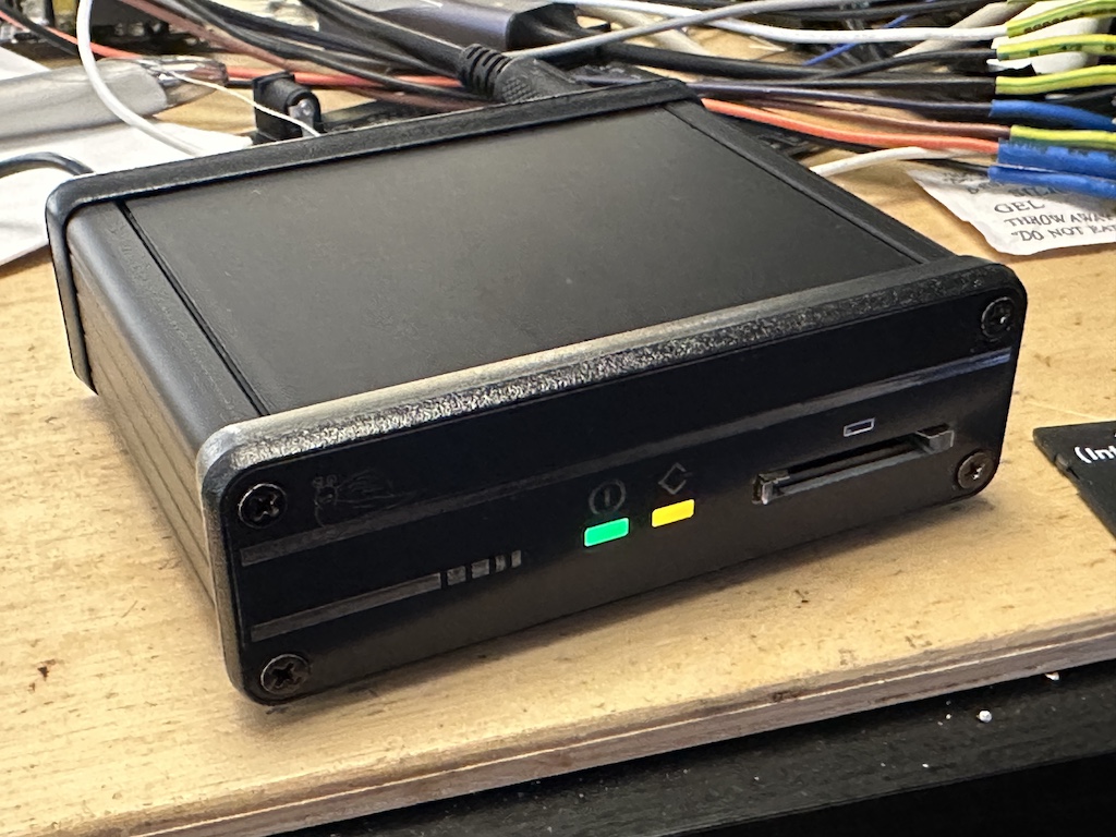

That looks really good. Just wondering are the led’s just shinning through the fr4 with no solder mask?
Thanks! Yes that's what they are doing. LEDs are kinda bright, and there is a small bleeding (not close enough) but it works fine.
Yeah, this is a really good trick (I picked it up from @demik too): it's not quite as good as light pipes but much, much easier and cheaper.
Credits where it's due, I stole that idea from old AV gear where they usually did this with smoked translucent panels
Really big thanks to @demik, this is awesome work! Also thanks to @cheesestraws for the graphics. Those are some snazzy panels, my spouse got a real kick out of seeing scuzzy the snail appearing again.
You are welcome! Thanks for your help as well! PR done, let me know if something needs improvement
