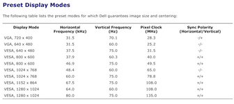

Here are my morning thoughts: I looked back in the thread and your monitor is the E178FP. From the Dell User Guide, the supported modes are as follows:
So...per the spec...you would ideally need a dot clock of 108Mhz for 60Hz or 135Mhz for 75Hz. According to the ICS1494 table, config $1F is 122.32Mhz. So, coming back to the discussion of the $0f clock selector and likely support for 1280x1024 (my earlier post), you can try setting $0f as the clock selector for 130.48Mhz, which is going to be closer to the spec for 1280x1024 75Mhz (within 3.3%) and your Dell monitor may be tolerant of the deviation...but there's still potentially a rounding issue. The monitor(s) tolerate 122.32Mhz, which is even further away. So...? You may get back the missing pixels.

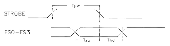

From the ICS1494 Spec:
Just look for the bfexts instructions that are followed by minimum setup and hold times for the ICS1494 strobe pulse. Let me look at the earlier Primary Init post...OK -- see the disassembly in this post.
Below is the code from @jmacz's disassembly/function_11 that matches the ICS1494 spec - number of bits, setup, strobe and hold. I added relevant comments and changed some of the disassembly notation.

So, from the above, the ICS1494 base appears to be at: $Sd0a0000 and the register offsets are:
$00: STROBE
$04: FS0
$08: FS1
$0c: FS2
$10: FS3
$14: FS4
Hopefully, the above is correct and will help move things forward. It looks right, but YMMV. :p :D Actually, you should be able to use this stuff in Macsbug to reset the clock in real time. Hmm...interesting.
The ICS1494 datasheet and mask configs were super-helpful! Those docs were great finds!
