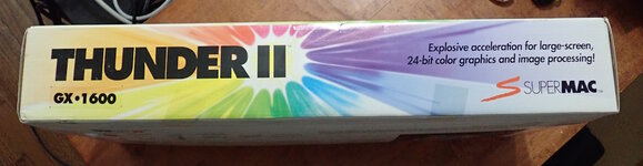

The back of the box. Interestingly, this is a big sticker. I guess this allowed them to update the marketing and customize the box for the GX 1600.
The end cap label says "Rev D". I don't see anything on the card that indicates this.

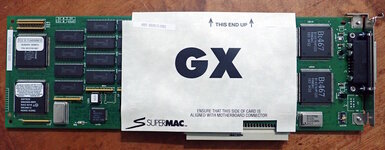

And now, most importantly, we have the graphics card.
Bodge capacitor on U226
Weird spacer or brace atop the daughter card. Solid -- not squishy.
The card works. It says SuperMac Thunder II 1600 v3. ROM Rev 3.0.3.
It looks like everything that says "GX • 1600" is a sticker. I wonder if it was to cover the printing on the box for a previous version.
Good eye. I do have three other SuperMac boxes: Thunder, Spectrum V, and Spectrum SI. They all have full page stickers on the back. However, they also all share the same printed box. So, it seems like SuperMac had a pattern of printing bulk boxes and then using stickers for details.
Maybe it was a common practice back then. I recall a box for something computer-related that also has a big sticker on the box. I'll have to report back what it is if I come across it again.

Can you read the part number off the U226 below the cap? ICS1562AM?
Also curious to know what's before the -001, if you can see it.
Yes. Good eye.
My other Thunder II 1600 (obtained a while back unrelated to this purchase) has ICS1562AM, 9424-001, AN172551, also ROM 3.0.3
Yes. Good eye.
Thanks! Just a date code before the 001 then. That indicates it's the parallel version. I'll pull some info into the other thread, but here's the B-rev datasheet: https://www.renesas.com/en/document...L3BeAPUZ7ONOKFfxSAQnSwKVGSBT90tUDrgEEKe-Ti17S
Seems like just a decoupling cap, wonder if it was catching static shocks from the connector.
