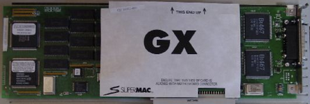

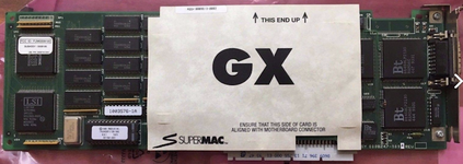

Below is a quick comparison of the Thunder II boards and some additional thoughts.
Thunder II GX 1360 pic below with 3x Bt458LPJ135, socketed DIP ROM and a 14.31818MHz clkRef for ICS1494. The DAC is an 85-pin plastic J-Lead package and marked as -135 -- likely indicates the top speed (135MHz).
Thunder II GX 1600 pic below showing a newer board layout, soldered ROM, 3xBt467 and an extra crystal in the lower right (that may just be a refClock or could be related to 1600x1200 -- can't really see it). Note that Bt467 is not pin-compatible with the Bt458 -- the package below is a 160-pin PQFP (plastic quad flat pack).
For 1360 vs. 1600 Thunder II boards, the hardware is clearly different. However, that doesn't mean that the 1360 board couldn't possibly work in a 1600x1200 config. The DACs do not appear to be maxed out can could be replaced with a -165 version (165Mhz).
According to Brooktree, the Bt458 can do 1600x1200 -- see the selection guide below (but it might require the -165 version). More research is needed. I don't know that there is another pin-compatible, high-frequency part. So, Bt458LPJ165 might be the only option for a max speed Thunder II 1360, but bear in mind that the ICS1494 clock generator also caps at 135Mhz. So, there would be no point in upgrading the Bt458 unless you also planned (and needed) to bypass the ICS1494 external buffering. FrankenThunder II! There might be something workable with the existing mask frequencies.
Anyway, the boards appear to be different, but 1600x1200 might still be possible with some hacking. If there are Thunder II 1360 and 1600 boards that appear the same, then SuperMac merged the designs either before or after the soldered ROM respin. If anyone has, knows of, or can find a DIP-ROM Thunder II 1600 GX board, please post a hi-res picture of it without the accelerator attached. That would be an interesting thing to see. Otherwise, if there is a Thunder II 1360 design with a soldered ROM, then we know that it can probably be upgraded to a 1600 with a ROM swap because it is likely just a gimped 1600 board with Bt467s on it. That would also be an interesting thing to see if anyone happened to have a picture.
