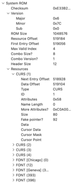

Resources in the PowerBook 160 System ROM:

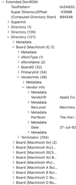

Pseudo-Slot Extended DeclROM data:

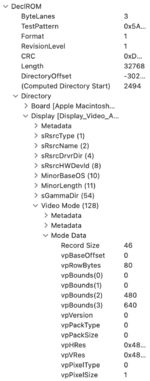

Video modes from the 24AC Display Board:
