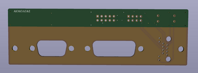

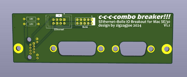

Also, here's the overdue combination breakout board. It's intended to work with Bolle's riser or halkyardo's SEthernet/30 ethernet boards, and allow you to install a VGA cable as I supply with the 30Video kits. It also has an opening for a DB-15 video connector as used by vintage mac video boards. I have not been able to test the compatibility with Bolle's riser however, so YMMV.
I'd recommend white solder mask if having it made at JLC.
(Rear)
(Front)
:D
(Rear)
(Front)
Unfortunately, I've heard this isn't working with Bolle's riser. I don't have one in order to troubleshoot it, however. YMMV
In other news I've been working with @retro apple mods in order to adapt his acrylic "CRT" front to work with my LCD kit panel/mounting. A different LCD bracket needs to be installed on the LCD panel in order for it to work, but it's not super difficult. You can send him a DM if you're interested!
(pretend the red is clear, and you get the idea)
:D
Stupid short edit threshold. The combo breaker as currently posted on github WILL NOT work with the bolle riser and SHOULD NOT BE USED unless these pins are removed (will prevent LEDs from working).

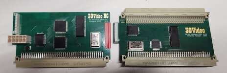

As a development update, I have 30Video variants I am working on with an eye towards maintaining my ability to keep making these in the future. Nothing particularly fun and exciting, I'm afraid, but figure it's worth noting anyways.
First is the plain 30Video card which is functionally identical to the 30Video SI and uses the same firmware. It's just a more compact version with routing tweaks. The slot-select switch has moved to the rear. It technically can be built in an IIsi version, but i don't plan to do that except upon request. So, the FPU option from the SI cards has gone away. I've been out of stock on the SI cards for a while so I should hopefully have these available soon.

As an update, I've got the new cards in hand and working.
The HC card is mildly amusing in that it enables 16 bit grayscale if the grayscale bits have been installed on the card. Mostly I intend for these to be LCD cards though so I don't plan to populate or test that functionality unless explicitly requested. Nothing terribly exciting to say about the LTS card on the right other than it works. Same resolution support as the older SI cards and color depths (so no 16 bit color). It will be a few weeks before I make these in any quantity as I'm focusing on development to finish qualifying these cards along with the NuCF cards in order to get my ducks in a row before the wheels entirely come off with regards to the US<>China relationship.
As expected, 16 bit grayscale is silly and visually indistinguishable. I'm doing some tricks to make 8 bit grayscale work in the first place, and it definitely looks like that hard work paid off. 16 bit grayscale also doesn't support the gamma correction the internal screen should have applied, so 8 bit definitely remains the recommended mode.
