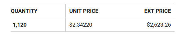

The one part I wasn't able to get sorted was a drop-in potentiometer for the external brightness knob. The original one is an odd combination of parameters and to get one that might work would require buying 500 of them in a go. Eugh. It's possible to DIY something that will work though.
This is something I was also playing around with for my stalled Analogous Board project (that I hope to get back to working on at some point). My idea is to use a top-adjust pot like this or this and mount it on a small custom PCB that could be installed perpendicular to the analog board with right-angle pins. I think it's possible that this could end up being a little bit cleaner solution, but I never got past buying the pots and verifying that the knobs fit.
I've put 3 sets of potentiometer holes on the new one to allow some more flexibility in the future. That gets the spacing to the front correct (with the bourns pot from the document, anyways), but the leads do still need to be extended. Might be able to find some pin receptacles that might get that right, or possibly a connector with the right spacing.
This pot looks like it'd be an exact drop in fit PTN24A-A1020DPB - but it can't be sourced.
Yah, let's not... P160KN2-0F (series) from tt electronics also looked doable but similarly can't be found.
The LCD adjust uses a 10K pot, it might work with a 5K also but I haven't tried as 10K is what was specified.
