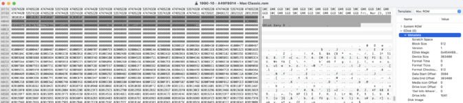

Circling back here, I'm deep in futzing but I figured I'd make an update. I disassembled the Q650 ROM from my personal machine and in the loop in question I see:
Code:
00000058 : 2478 02ae      MOVEA.L  $000002ae,A2 # RomBase
0000005c : 6100 00e2      BSR      $00000140 # CheckForROMDisk
00000060 : 660c                BNE      $0000006e # FindNextROMDisk
00000062 : 7200                MOVEQ    #$00,D1
00000064 : 240a                MOVE.L   A2,D2
00000066 : 260a                MOVE.L   A2,D3
00000068 : 616a                BSR      $000000d4
0000006a : 4dfa ff82      LEA      -126(PC) {$4294967278},A6
FindNextROMDisk:
0000006e : d5fc 0001 0000 ADDA.L   #$00010000,A4 # Move to the next offset
00000074 : b5fc 00e0 0000 CMPA.L   #$00e00000,A2 # Check if we're past the end
0000007a : 65e0                BCS      $0000005c # Return to the search loop
(Note the offsets are from the start of the Open routine...ish)
(Also this disassembler totally has a bug and d5fc should be an ADDA.L to A2, not A4...funny)
So, roughly, we're searching from $000002ae to $00e00000. In other words, the whole code assumes we're still based at $0, and it'll search the first 14MiB of memory space, if I'm understanding it correctly.
So unless I'm missing something, I'm not actually sure why this code doesn't work. There's no system checks before this, and the resource is marked for all machines.
