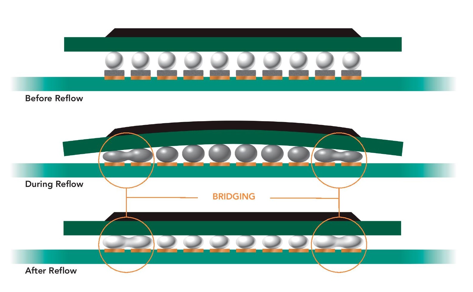

The thing I'm the most worried about now is the warping of the BGA substrate. It's only 0.3mm thick! During desoldering, it warped into a dome shape similar to the "during reflow" picture below:
While the part was hot, I had trouble getting a thin tweezer under the edge of the part to lift it, because it had warped to the point that the edges of the substrate were almost touching the board. The tweezer fit easily under there before heating.
The information I'm reading online suggests using spacers under the edges of the part to mitigate this. It seems that for the 0.76mm balls, I would want about a 0.6mm spacer. I'm not sure whether this would be overkill or not. At least I only have to worry about soldering the perimeter of the part, since there are no pads in the middle. Maybe I can get away with using a PLCC nozzle on my hot air gun, which will focus the heat more on the edges? I'm not sure whether that would reduce the warping or not.
Are you using a PCB preheater?
Warping is greatly reduced if you do, both for the chip substrate as well as the logic board PCB as well.

It's unfortunate the T8280 preheaters seemed to have been discontinued, they're harder to get and more expensive than they used to be, but have a far larger heating size, heating the board more evenly and quickly.
You really do want to heat soak the board, I've worked on this type of chip on a 3DFX card and had no warping on it, so give it some time to properly heat up.
This also greatly reduces the risk of popcorning, in which case moisture within the chip substrate is heated rapidly, causing it to turn to pressurized steam which will blow through the substrate to escape, completely destroying it in the process.
Ideally a board should be slowly prebaked to completely remove this moisture, but I haven't done this on any of the boards I worked on with the preheater, and have never had issues with that, despite these being 20+ year old boards that have had plenty of time to collect moisture.
