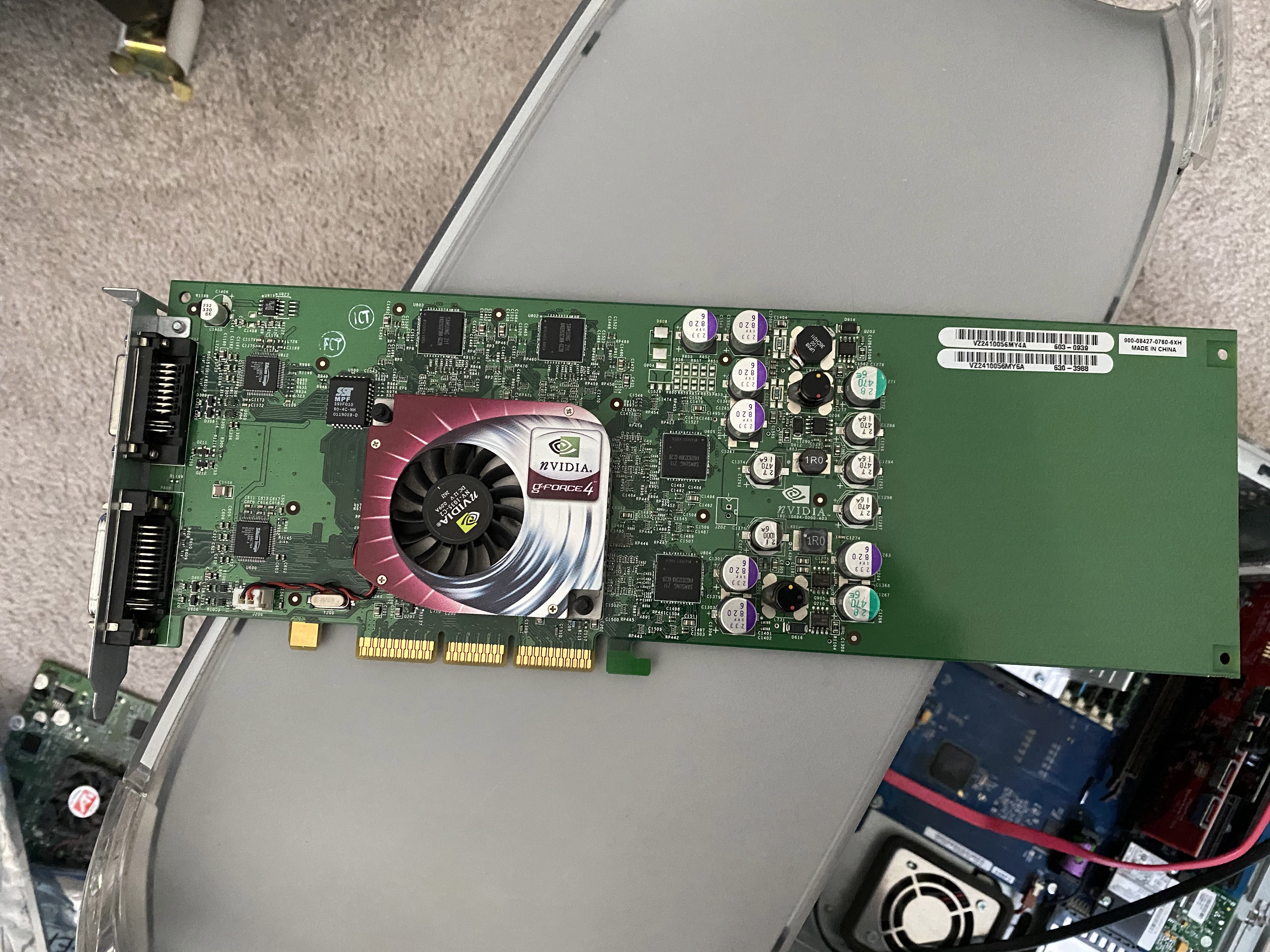

Here's one of the cards I ended up buying. This is just the picture from the eBay listing because I didn't take any of my own beforehand:
Any veteran of the capacitor plague will notice that the green through-hole cap, 5th down from the top right, is trouble. It hasn't started leaking yet, but it's bulging, so its days are numbered. That's C1267, and it was either bulging like this, or had started to leak, on every card I got. It's a Sanyo WX series, so not total junk, but this circuit design clearly works it hard.

Great post, thanks for detailing everything. I own a Quadro4 980GXL and it came from a house fire, but that didn't stop it it's been going strong in a Pentium-III based system for years. Yet to recap it. Love the card, and confirm every single Radeon 9700, 9800 I've come across has never worked.
Thank you!
When I say they're unreliable due to bad cooling, I am unfortunately lumping the 9700, 9800 and Geforce4 Ti cards together. I agree the 9700 and 9800 are the worst because ATI chose to put the RAM chips directly back-to-back, and the Samsung DDR used on the majority of them runs hot. The heat cycles appear to break solder joints over time, which I believe is why so many of these cards develop artifacts. The design of the Geforce4 Ti cards appears to be slightly better; NVIDIA chose to offset the RAM chips on opposite sides of the board by roughly the width of the chip, so the heat isn't quite as concentrated, but they still develop similar problems. The Quadro4 700 XGL should be the best, since it has RAM on only one side of the board (and it's slow!), but one of my cards still needed one of its chips reflowed, so they're not immune either.
The GPU coolers on all of the cards are dinky. They're just barely adequate when they're in good shape, but as soon as the fan starts to clog with dust and/or the bearing starts to fail, the GPU won't last long. I see this especially on the Geforce4 Ti cards: the PCB will turn brown underneath the GPU from the heat. Here's an OEM Apple Ti 4600 currently listed on eBay for $900 Buy It Now, untested, as-is, no returns, and the seller notes the fan seems stuck:
I wouldn't be willing to bet $100 on that card working, let alone $900!
Among Geforce4 Ti series cards, though, I agree that the Quadro4 XGL 980 is the one to have; relative to most of the others, it's a tank. They revised the power supply on those, and all the ones I've seen are built with high quality components. I've never seen one with a blown cap. I wouldn't even bother recapping one that was still working fine; the large ground and power planes make them annoying to work on. Take care of the GPU cooler and it should last a good long time.

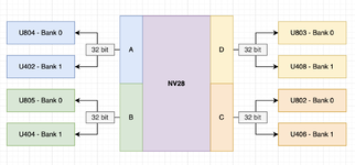

I finished working on a Quadro4 900 XGL last night. After repairing damage to the board and replacing capacitors, it worked great in a PC. The device ID change for this one to Ti 4600 is easy; just one resistor needs to be moved on the back of the card, R963 to R962, to change device id 0x258 to 0x250.
Because this card has 128MB of RAM and is capable of the same clock speeds as a Ti 4600, it can run the unmodified Apple Geforce4 Ti 4600 ROM. The Mac firmware is booby-trapped, though; it checks a strap bit for Mac vs. PC, and if it's not set correctly, it halts. You can see all of the strap bits and which resistors set them in the schematic linked from my first post. The resistor that needs to be moved is R966 to R967. These are just a bit down and to the right of R963 and R962. With that done, the device ID changed, and the ROM flashed, the card works great in my G4.
The "Mac switch" resistor doesn't need to be moved on the Quadro4 700 XGLs using Arti's modified ROM because he masked it out. I don't think it would be too difficult to modify the ROM in the same way for the Quadro4 900 XGL, but since I'm already nearby with a soldering iron changing the device ID, just moving one more resistor isn't a big deal.
Here's a comparison of OpenMark scores between the Quadro4 900 XGL (equivalent to Ti 4600) and the Quadro4 700 XGL, posted from the actual machine using AquaFox :)

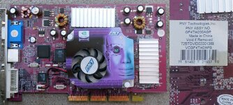

I have a Ti 4200 with a massive copper heatsink on the GPU, and the memory chips back to back. But at the lower speed maybe that's fine. I've never located a Mac ROM for it, and never undertook the challenge of editing one myself.
None of the OEM cooling fans of that era were any good and easily clogged up over time. Even if the caps were decently made the cards tend to cook them because of bad airflow.
PC gamers are buying up both the Geforce Ti 4xxx series and the Quadro 4 equivalent for Windows 98 gaming ages ago because the ATI 9700/9800 models were dying and were expensive to begin with (plus they want DVI).
Is the RAM on that in TSOP or BGA packages? The TSOPs are generally robust.
Someone leaked Arti's old ROM Maker apps on MacRumors a few years back, so you can have a go at making a Mac ROM for your card if you want to.
They’re TSOP.
