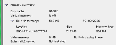

I have a PowerBook G4 Titanium 400 MHz with failed L2 cache. When I try to boot into Mac OS 9, I get an error message to this effect. I can't remember the exact message, and I have taken the machine apart now so I can't easily find out, but I don't think it's important in itself. Apple System Profiler shows the machine as not having L2 cache (it should show as 1 MB).

Just for the sake of it, I tried to enable the cache using Powerlogix G3/G4 Profiler and it caused the system to freeze instantly - which is no surprise I guess. I have attached some screenshots of how this shows up in the OS and G3/G4 Profiler, just because this issue hasn't been documented much online.
