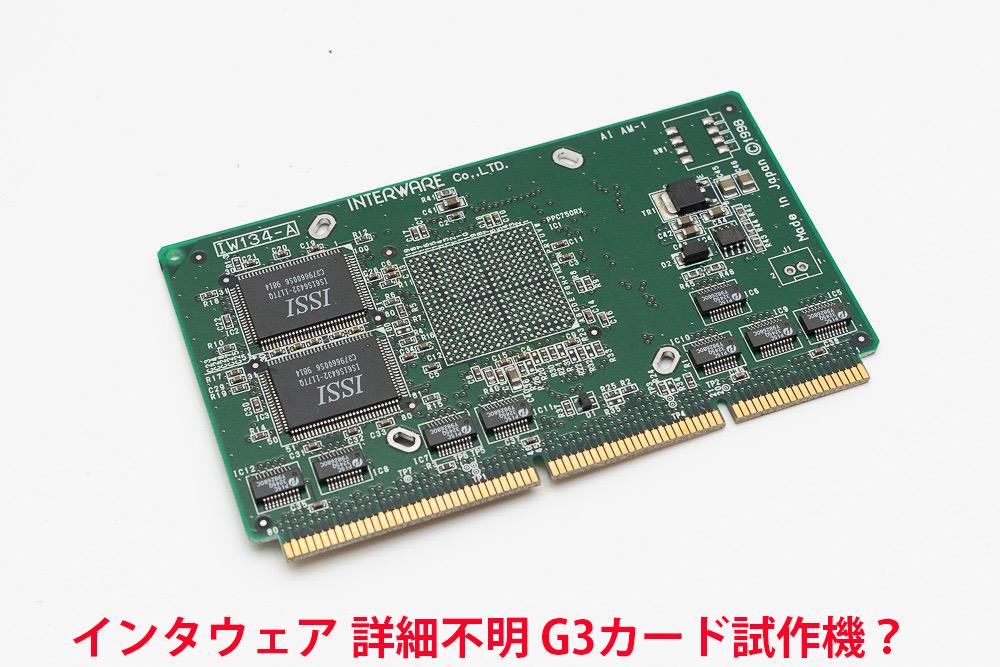

In the meantime, @finkmac pointed me to something interesting on the Japanese Mercari marketplace:
It's a G3 accelerator card for the Power Macintosh 4400/7220, or Tanzania clone boards.
But crucially, it's missing the actual chip, and the seller thinks it might be a prototype.
In any case, too interesting to pass up, so I've gone ahead and bought it through a proxy.
I might go ahead and see if a 7400 G4 could be fitted in place of a G3, as if it's anything like the Sonnets of the era, it should.
That said, I don't have a Tanzania based Mac (yet), but the L2 cache slot of the Tanzania is identical pinout wise to the Alchemy (5400/6400) and Gazelle (5500/6500/TAM) boards, and uses the same chipset architecture (PSX + O'Hare).
It might not fit in my 6400 chassis, or be a tight squeeze, but if I can set up a test bench type setup with an Alchemy or Gazelle board, I should be able to test it without needing a Tanzania board.

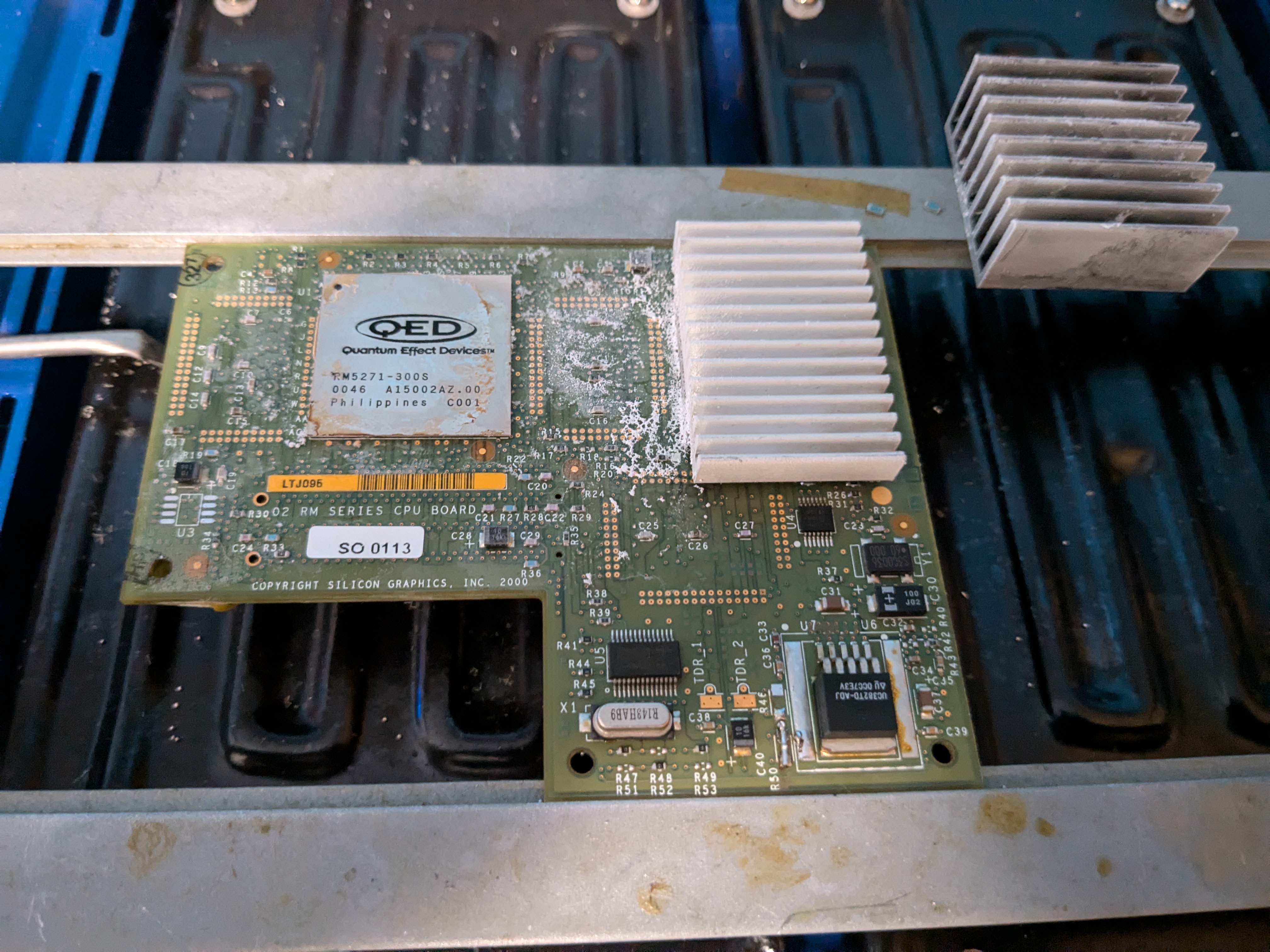

Since getting my O2, I've had the plan to try and fit it with the 600MHz R7K CPU through a BGA swap on a 300MHz R5K card.
This is an old school upgrade, as described here, so doing it 20 years later did require some workarounds :p

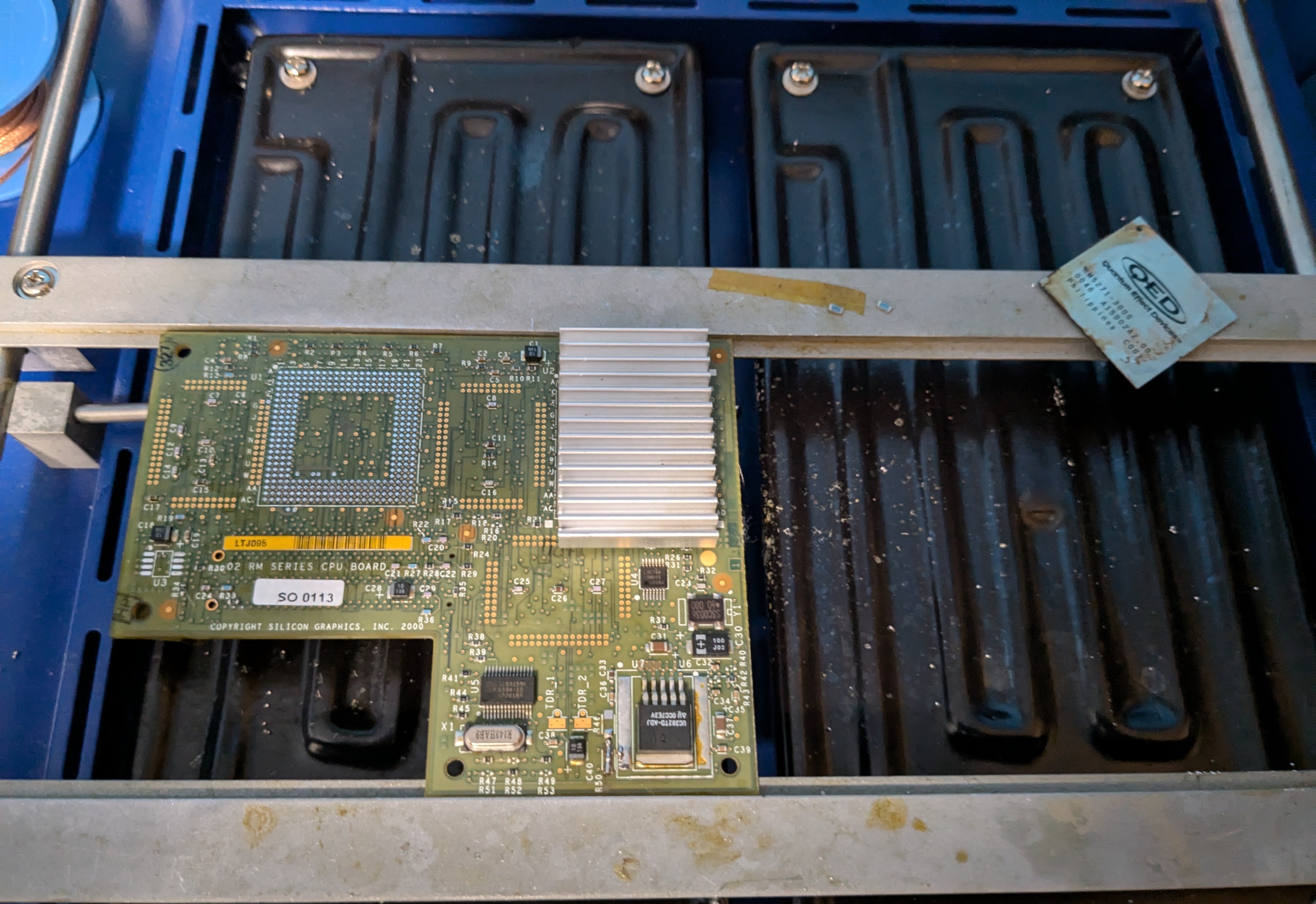

It's been a couple of years now, but I've finally made the move to BGA soldering in the last few months, and after getting comfortable with it, I've decided to start on the SGI.

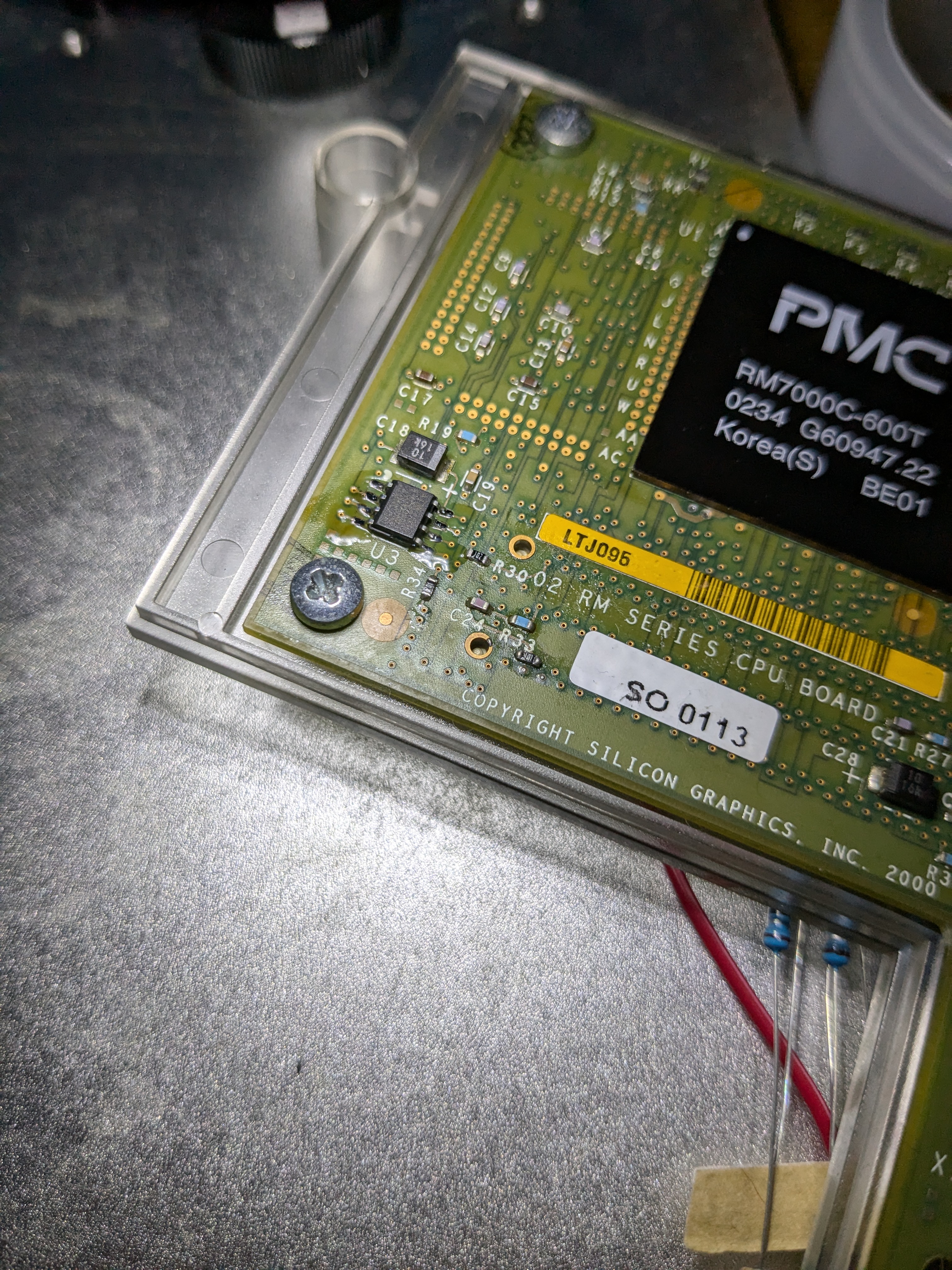

After removing the PROM and voltage regulator adjustment resistors, and fitting a simple bridge on R50 to set the vCore regulator to 2.5V, I removed the heatsink:
(yes, my PCB preheater needed a clean, and got one after this project :p)
I use the method seen here, though I just use a can of compressed air held upside down, as a cheap freeze spray.
Once the heatsink is properly frozen, I put an old bank card under the heatsink at the bottom (above the yellow barcode sticker), then pop it off by wedging in a screwdriver, the card keeping the driver from digging into the PCB below.
Next, the CPU is desoldered with hot air, with the PCB preheater keeping the entire PCB reasonably hot to prevent warping or popcorning, and a good amount of flux applied around the old RM5271 CPU.

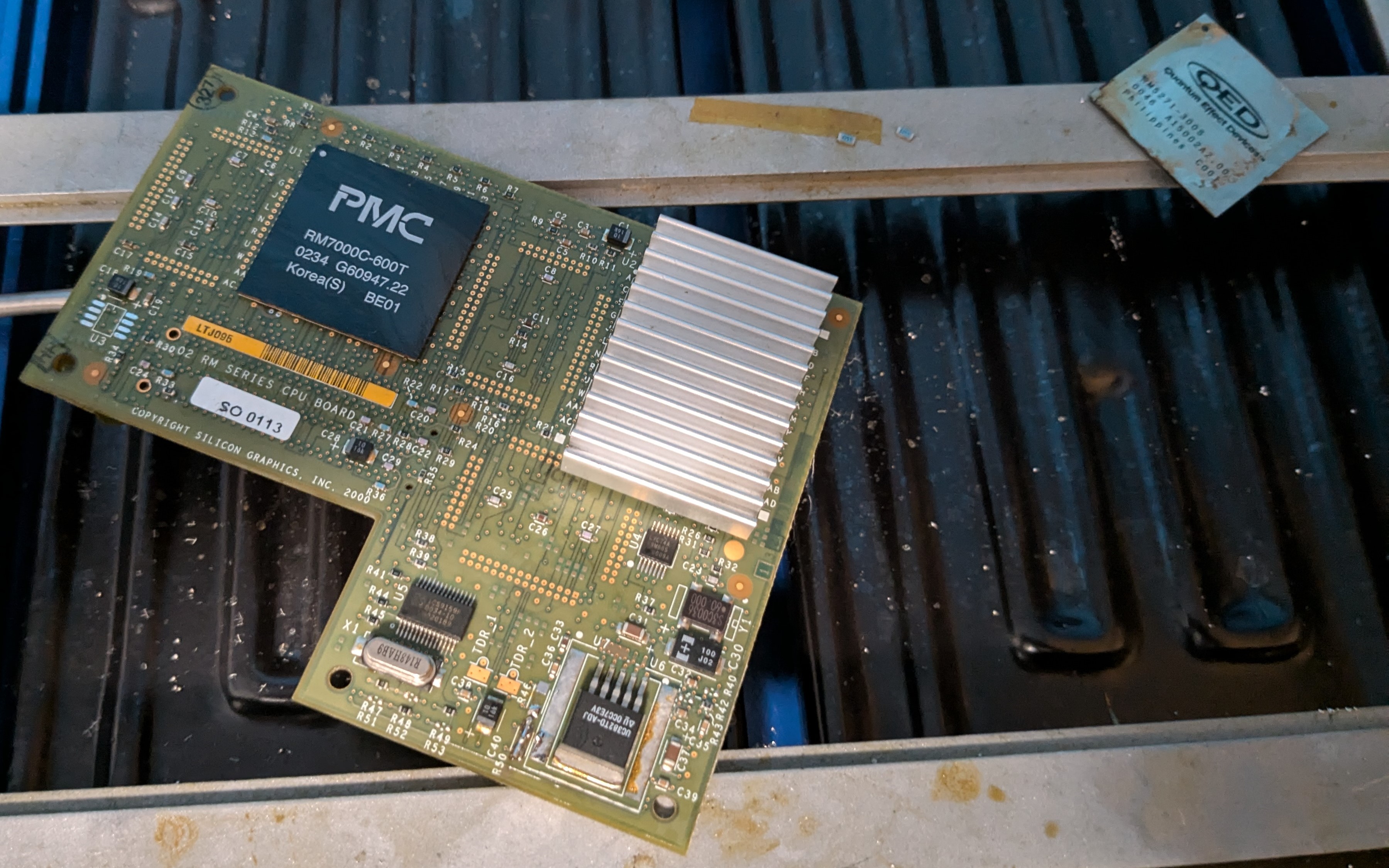

Once it's off, I then clean the pads with some solder braid:
Finally, the RM7000C-600T is placed on the PCB, on top of a good bead of flux, and carefully aligned to the board, after which I solder it on.
Once I see the chip slightly moving into position and sinking a bit, I know the CPU is soldered on correctly, and I let the PCB cool down:
Now, with that done, it's onto the PROM.

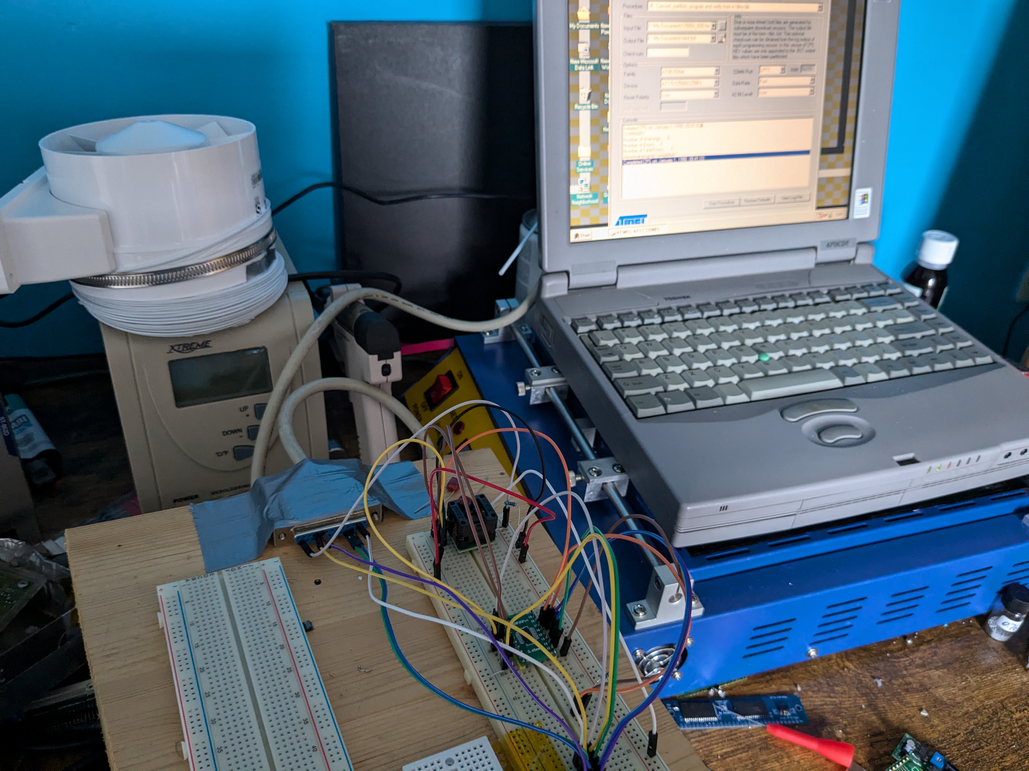

This part is a bit tricky, the original Xilinx PROMs are read-once, meaning you need to source a replacement, and hope you aren't getting old ones pulled off scrap boards if buying from China.
I was tipped by someone on the Silicon Graphics User's Group forums that the reprogrammable AT17LVxxx series would likely work in place of the Xilinx PROMs.
The programmer Atmel sold for these was the ATDH2200E, which has the schematics for the programmer listed in the manual.
So, I did the entirely reasonable thing, and just spent an afternoon recreating the necessary bits of the programmer on a breadboard, using a 90s Toshiba laptop as the programming computer.
For the PROM, I'm using a simple DIP adapter from my TL866 programmer, and as the necessary 74 logic IC was seemingly only available in SMD, I soldered that onto a DIP adapter as well.
Bit of a spaghetti situation, but it worked!
I did have to use Atmel CPS 7, CPS 8 gave me weird "0 AT17LV65/256 devices needed to download" errors when trying to program the chip.
In CPS7, loading the .MCS file with the "Convert, partition, write and verify Xilinx file" option worked fine, with it converting it to a .BST file and programming that in turn.
After verifying that reading the chip as a 64K device (AT17LV65) still gave good results, I went ahead and soldered the programmed chip to the CPU board:

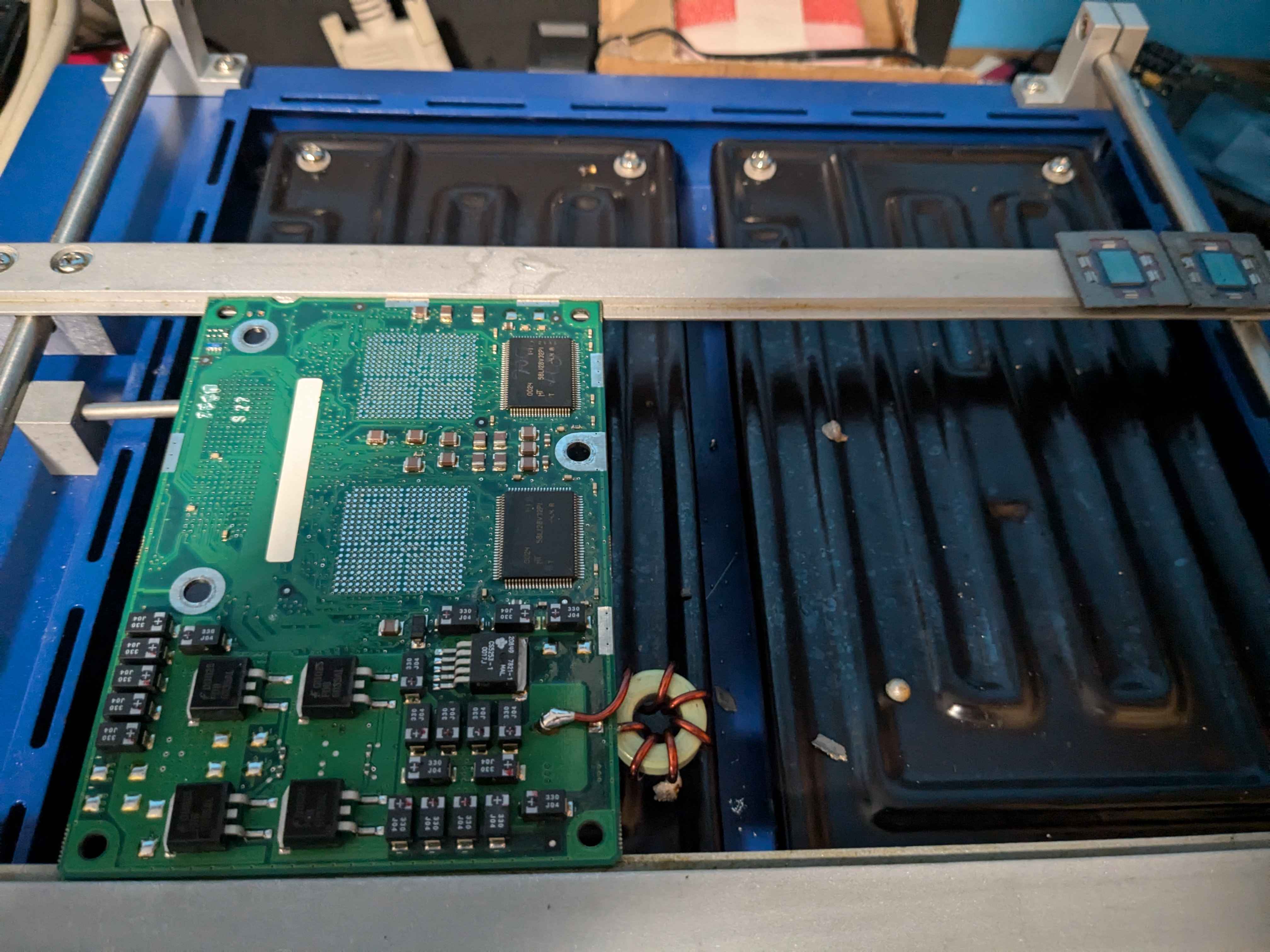

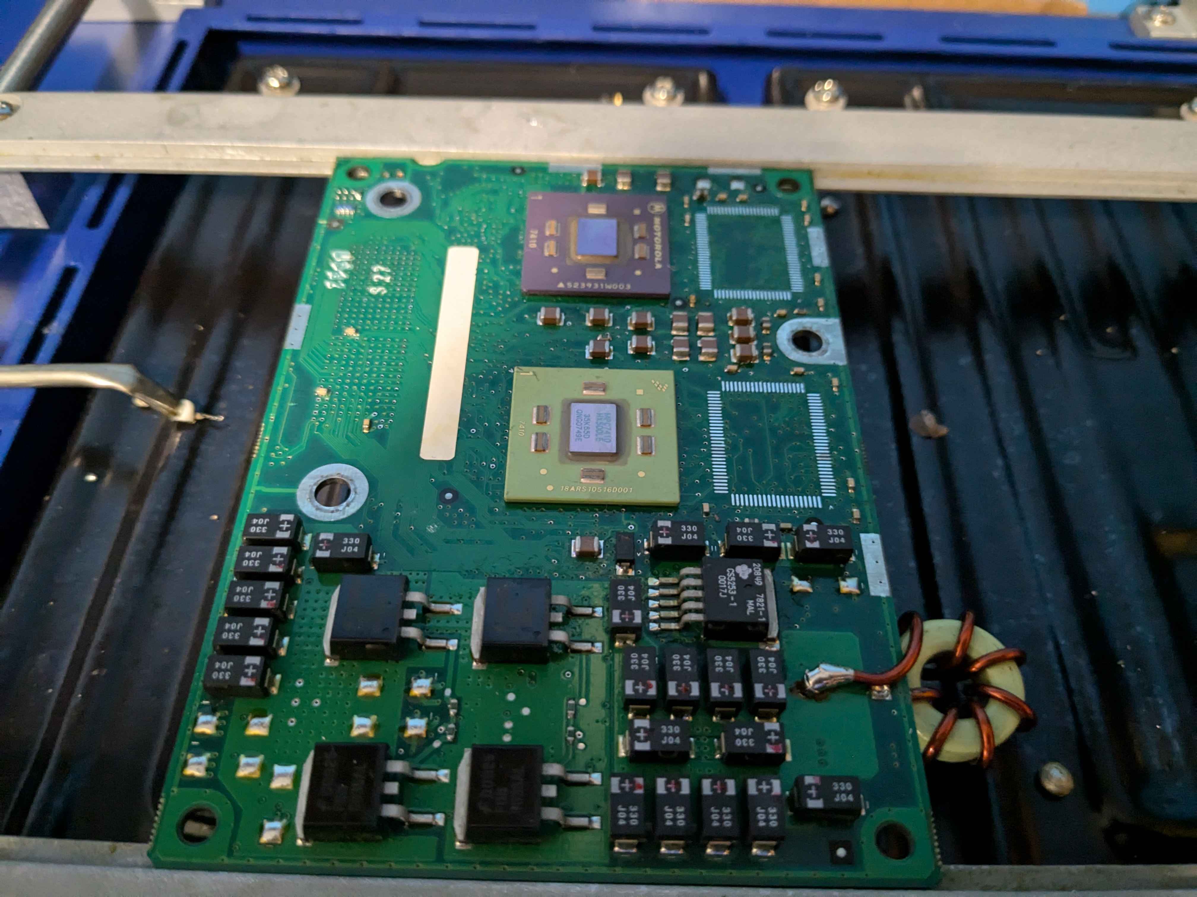

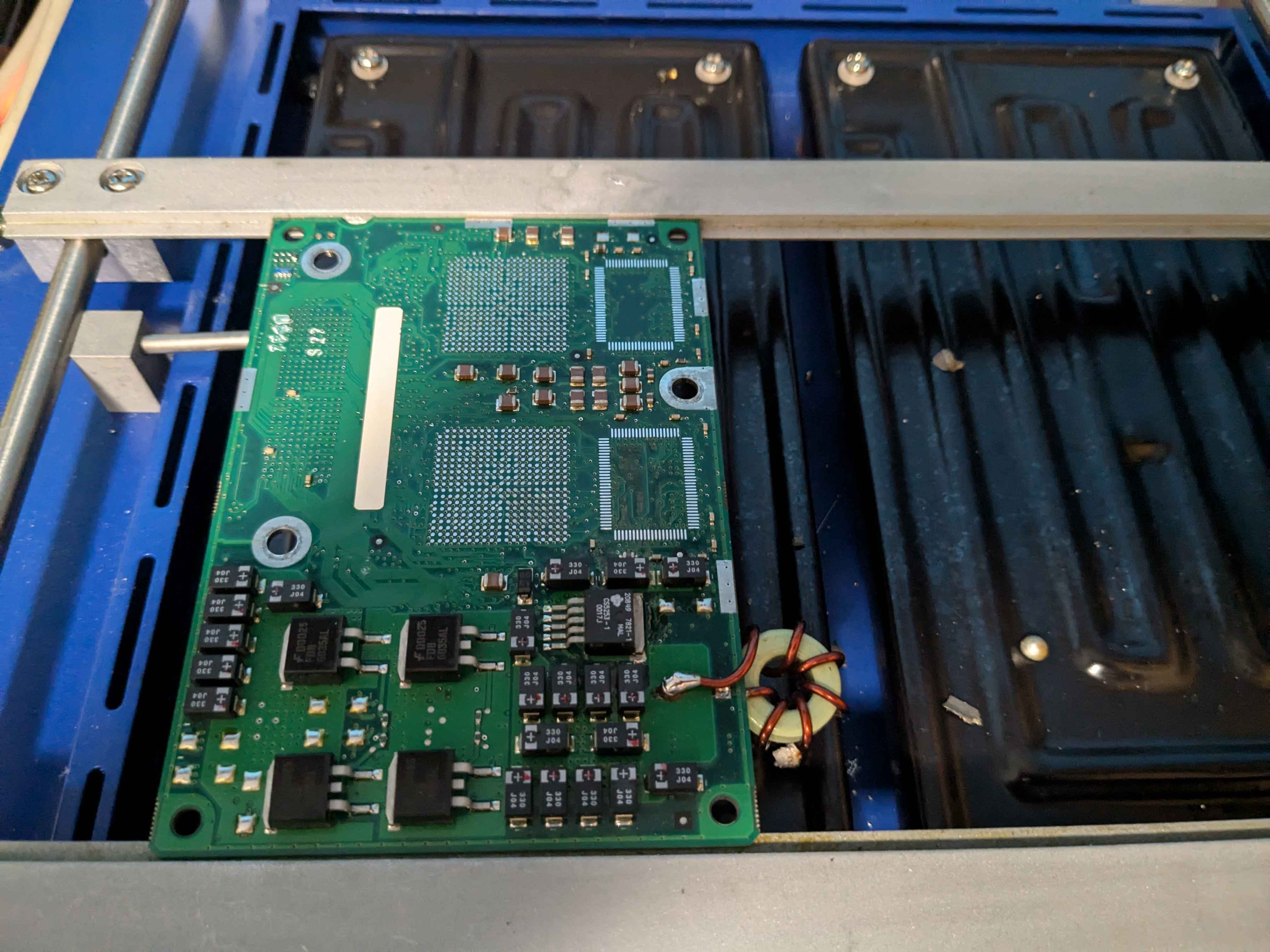

Doing some BGA + QFP work again, this time on a dual 450MHz G4 card destined for my G4 Cube:
Went for a pair of mismatched 500MHz 7410 G4s (same mask though), which are basically just slightly updated 7400s like the 450MHz ones they're replacing.
Main reason for doing this, is because the 7410 is die shrunk and uses less power (and outputs less heat), so I won't have to necessarily get an expensive aftermarket Cube VRM module to stop it from blowing up.
That, and the 7400s are 3.3V tolerant on the I/O lines to the backside cache, where the 7410s aren't.
On certain G3 CPU boards, like the iMac G3 Trayloader CPU cards, the cache can't be adjusted to operate below 3.3V, so using 7410s for a G4 upgrade there will result in a dead cache controller on the 7410 (it will still work, but it can never use L2 cache again).
So I can reuse those 7400s for other G3 -> G4 upgrades.
I'm also yoinking the cache, as hopefully I can get some 250MHz rated 1MB chips (two per CPU, one on the top and one on the bottom), to double the L2 cache.
I can then also reuse the 512KB cache chips from this board for iMac G3 Trayloader cards, which have 512KB (2x256KB) of L2.
So I'm partially upgrading, to be able to continue upgrading :-P
The lack of silkscreening on this board made aligning the chips a bit more of a PITA, due to the lack of an outline for reference, but it worked out.

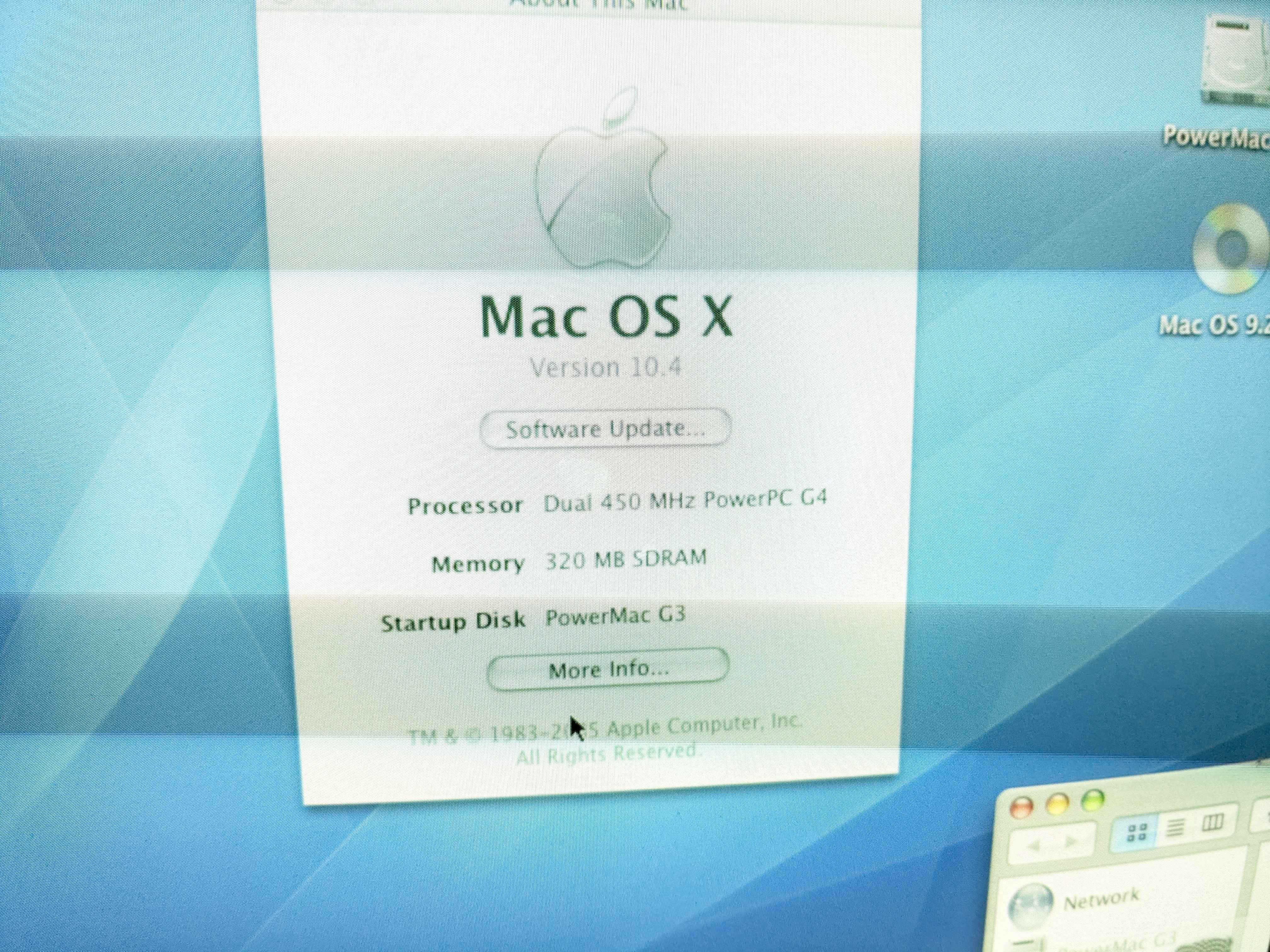

After wrangling the dead Deathstar out of my Cube, and putting the card and an HDD from a PMG3 B&W in, all's well in OS X 10.4:
So I'm partially upgrading, to be able to continue upgrading :p

When heating up these CPU daughtercards on an IR preheater, how do you make sure you don’t melt the plastic connector on the underside? Do you protect it with aluminium foil… and is there a safe maximum preheating temperature?
I do stick kapton tape over any and all plastic connectors, but generally my preheat temps (180C-ish, off the top of my head at the moment) don't seem to really cause issues with the bottom ones. The heat from the reflow station on the top of the board is definitely the bigger thing to keep away from the plastic connectors on top.
Danieel,
can you suggest a good Ali or Ebay seller that has a compatible G3 CPU for the 6500 board? Something I can do a direct swap, and also compatible with what is possible to obtain by the small VRM onboard….
At least Firmware wise the L2 Slot in Tanzania and Alchemy/Gazelle is different - maybe even some address routing. Something I learned when I and my colleagues developed G3 cards in the late 90s. The Tanzania can directly boot from a CPU in the L2 slot without any additional software (then of course the L2 Cache is disabled). In contrast, Alchemy/Gazelle first start with the onboard 603 and need an init to change the booting process and restart out of the L2 cache slot. So, both need some software to enable the backside L2 cache but Alchemy/Gazelle additionally need an init to switch CPUs.
Coming back to this, I did see that the Tanzania schematics surfaced, one big difference is that the interrupt going to the L2 cache slot is the CPU interrupt line, not the shared PCI Slot C interrupt line like on the Gazelle (and presumably Alchemy), which I suspected was the case. The Gazelle schematics specifically mention it's using that shared interrupt line, because they're not intending for the interrupt to be used in the first place (makes sense if they did not intend for CPU upgrades). That, and there are Checkstop in and out pins that are marked as "spare" on Gazelle/Alchemy.
I wonder if that might play a role in the CPU card compatibility? I'm guessing the Alchemy and Gazelle CPU cards do some low-level trickery to get the system to recognize the Slot C interrupt as a CPU interrupt line, which wouldn't conflict with anything else given it's not used otherwise anyway (the PCI ATi chip on Gazelle has its own distinct interrupt line). I'm kind of curious what were to happen if the interrupt line to the cache slot were to be cut on an Alchemy or Gazelle board, and the CPU interrupt line patched back in, potentially along with the Checkstop lines.
