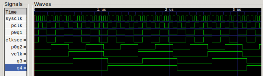

Another note, I also looked deeper into the Unitron's logic equations and tried coding them up in Verilog mainly to run a simulation that I could compare the BBU's waveforms with.  Indeed this was helpful in answering a few last questions, though it did feel a bit like a "distraction" from the BBU.  One interesting note, though, I found the Unitron's C3.7M clock is generated by inserting two C16M cycle waits every eight C4M cycles, rather than one C16M cycle wait every four C4M cycles.  It could be that the original Macintosh actually used this behavior, but of course there's no need to copy the inferior approach for the BBU.
