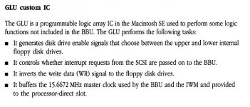

Well it's a success, reads consistently as a 27C020 - no matter the manufacturer - although the AM27C020 seems to work best.
So - here's the final code revision for the GLU logic - anyone able to verify this against the GLU's own description in Apple's own hardware manual?

`OUTA` and `RTXCA` look suspect, `RTXCA` will always be one with that logic so apparently you cannot enable synchronous modem use?  Not like you could ever do it in earlier Macintosh computers... I'm guessing the hardware manual's passing mention of this is because the feature was cancelled late in the product development.
Otherwise, I'd say everything else looks good when also consulting the VIA register layouts in the hardware manual.
