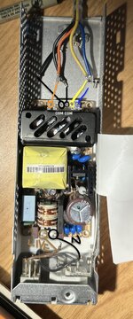

I’m back on this project thanks to being reminded of it in my other thread about fixing a ton of Macs.
I’m staring at my wires and the wires in the photos people post for using the Meanwell power supply, and I’m confused. The LC wiring plug has blue, empty, yellow, orange, empty, black, black. I see that the meanwell puts black wires in the middle. Are they both the same? Can they interchangeably be flipped between black/black? Or is one black different than the other?
I think I posted this in the other thread but I hadn't actually carried it out at that point - I connected mine like this and it works great! I removed the connectors on the Mean Well, stripped the ends of the wires from the connector I took from the LC PSU, and taped both the Mean Well AND the inside of the LC PSU case to make sure it didn't touch and short. Works great! The LC it's in has been running Snooper RAM tests all day, no issues
