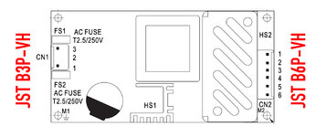

I’ve sourced some of the Meanwell RPT-60a power supplies in an attempt to properly restore the collection of LC Pizza Box Mac’s I have.
With the Meanwell PSU, there are pins and connectors for the AC input end and for the DC side that is the output end.
I’d like to just strip the wires from the power switch and put a connector on, and strip the wires from the DC side that are on the PSU end of the wiring harness that goes out to the board. I then want to be able to just plug in the connectors on the AC side and the DC side into the Meanwell connectors without modifying the Meanwell at all.
Can this be done? What would I use? I was thinking DuPont connectors.
this is a great idea, non-destructive edits are best.

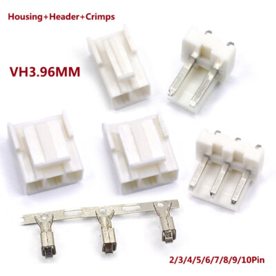

the connectors on the Meanwell board are JST VH, get some maybe with leads already on and splice onto power switch etc.

In case anyone else wants to source connectors for these Meanwell PSUs, I've purchased some (won't get them for about a month) from a seller on eBay:
They are listed as being the ones needed, but I don't know 100% for sure until I receive them.
Thanks to @AEChadwick for your help in figuring out what connectors the RPT-60a needs!
