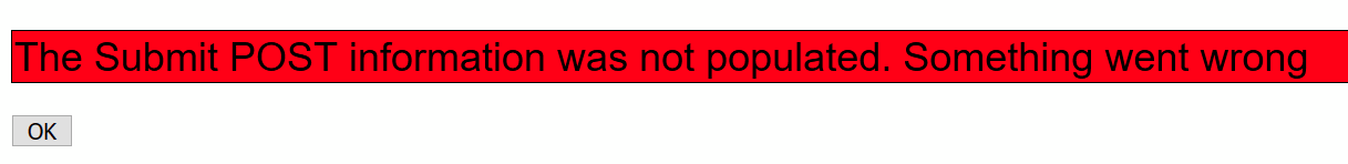

I’m getting a POST error (not written) when trying to upload ISOs from the web app. Is this not fully implemented yet or did I do something wrong during setup. Everything else works great!
Getting around it by setting up an SMB share for in the fly uploads, but it would be awesome to do it all right from the web app.

Just to confirm, has the upload_max_filesize setting in /etc/php/7.3/apache2/php.ini been changed?  The default is 2M, but the wiki talks about bumping it to 1200M.
If that setting has been changed, is the CF card out of space?  You can check free space with ...
df -h
but I suspect free space is not an issue on a new installation.
df -h
Yes, upload bumped to 1200M. 30+ GB left on the cases, no issue uploading ISO’s via smb.
