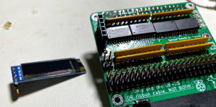

How many gpio pins are left unused on the Pi? I wonder, if we have enough to run a small i2c bus, if we could add a small LCD or OLED and a few buttons to the board to switch CD images or the like. I've been dreaming of a FlashFloppy-style device for SCSI CD emulation since I got my Mystic a couple years ago.
I thought the same thing! For this version, I broke out the i2c and VCC to a separate header to attach a super cheap OLED. I haven't got around to writing any code do do anything with it, but that shouldn't be too tough. You could also easily add a much larger screen, but I'm trying to watch the budget on this project :-)
image.pngimage.png(Ignore the fact that my pin headers aren't soldered on straight....)
As far as buttons, GPIO pins 4,5, 10-27 are used for the SCSI interfaces. GPIO 2 and 3 are used for the I2C interface. So, that leaves GPIO 0,1,6,7,8,9 that you could use for user control. You could also add a I2C GPIO expander and get as much I/O as you want.
