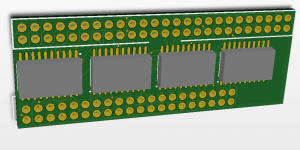

Threw together a minimal version of the board, just two headers and the 4 chips (no on-board termination). Hope I didn't make any mistakes, and OSHPark likes it, and I didn't miss an important component. :D  https://oshpark.com/shared_projects/FLWSmnqS (Board file / schematic is here, but I don't think anyone uses CircuitMaker haha https://workspace.circuitmaker.com/Projects/Details/Edward-Halferty/rascsi )
That is awesome!!! such a cute little guy :-)
Something you might consider on the next version would be to make it the exact same size as a Pi Zero so that you can mount it directly on top of (or under) a Pi Zero.
I'm excited to hear how it works!!
