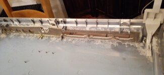

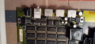

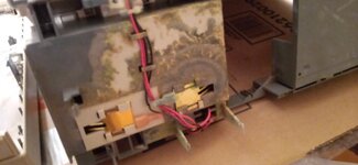

The lead acid battery leaked and ruined the battery compartment. Thankfully it looks like the damage is minimal, maybe a replaced adb connector anIMG_20260328_181025.jpgd headphone jack, or "shudder" traces!IMG_20260328_181027.jpg
I cleaned the board and it looks like there are just some leaky caps, and the damage on the front of the connectors.
