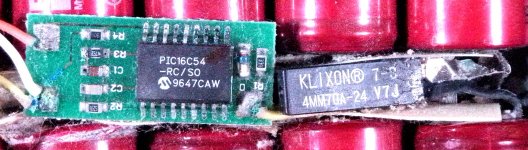

The mysterious BTI goodies hidden within:
Looks like just traces on the PCB flip side, mo-n-betta pics if you so desire, Mr. big. ;)
I'd love to get this gunky junk into the hands of someone competent before I have a chance to barbecue it, now that it's been marinating in acid, lo these many years.
BTI is still around, if such a competent person were to approach them, information might be forthcoming . . .
. . . like the freakin' missing power specs on these %({*@]*%^&+$^ Panosonic NiMH things! ::)
Other stuff too if a competent comrade were to get in touch with an oldtimer engineer over there. I got no chance of pulling that off a-tall!

That BTI battery is neat, but is there anything about the NiMH cells we don't already know? The original Duo batteries are just 10 regular NiMH rechargeables in the 1000 - 1800 mAh range, depending on what type of battery you have. The Mac shouldn't need to know or care whether those are AA, 4/5 AA, AAA, or some other shape as long as they're compatible electrically.
The cells in the BTI are way too high capacity to charge (safely/at all?) in the Duo without that micro-controller based intelligent circuitry.
