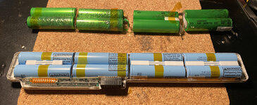

The batteries I got were from Cell Supply in the UK, I ordered 8x LG MH1 units which are rated to 3200mAh and seem to be quality parts. The extras seen in the photo below were for another rebuild (for an IBM ThinkPad T23), which was also successful.
I had to fight a bit with the plastics to get the battery open. The old cells were looking fairly worse for wear, but hadn't leaked any corrosive fluids.
A closer shot shows the construction of the battery a bit better, basically as far as I remember 4 pairs of cells are connected in parallel; and then strung together. I unfortunately didn't take photos of this stage of the rebuild. I did use a spot welder and some new metal strips to carefully replicate the existing design, which will be clear enough once you have the unit apart (and is pretty well explained in The 8-Bit Guy's video).
