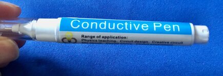

I got me this conductive pen from ebay..I hope this will work on my 270c keyboard layers..
so, you just draw with this pen over the surface of the copper traces?
