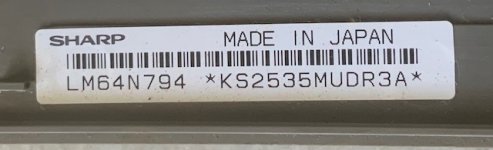

And lastly the LCD panel capacitors:
The passive matrix LCD display was working pretty good from my prospective but again the capacitors would eventually go and I had already had some experience replacing caps like this on my PowerBook 100’s LCD panel.
PowerBook Duo 230 Sharp LCD panel (LM64N794) capacitors:
8 x 3.3uf - 35v - “Plastic Encased Electrolytic” (C1 - C8)
Those are the same quantity and specifications as the capacitors I had replaced in my PowerBook 100 LCD! In that case I had used size B tantalum capacitors but even with their small size it was a somewhat tight fit.
After reading this post I decided to use smaller Multilayer Ceramic Capacitors (thanks @superjer2000!)
<link lost>
Info with Mouser part number:
8 x 3.3uF - 35V - MLCC (C1 - C8) - 810-C3216X7R1V335M6A
Removing the old caps showed a couple had started to leak and corrode their pads.
...another partially reassembled test ....and success!
Before:
After:
Above pictures are with default brightness and contrast. It’s subtle but definitely improved, noticeably less banding overall in use. Re-capped passive matrix screens look pretty good to me! Wonder if the modern capacitors actually perform better than the originals?
