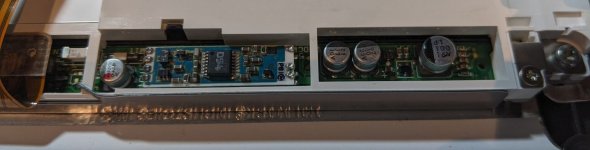

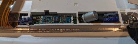

Powerbook 190cs full refurbishment & re-cap
