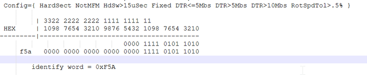

First, the driver does read CHS values from the disk: I tested 93.75 MB working (CHS 800 6 40) which all values are different from the original drive. I am sure there is a limit somewhere but I'm in no hurry to find it :)

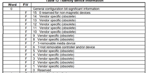

Any hdd old enough to reply with an ATA-1 identify matching what it expects could work, or a zuluide set to spoof that as I did. It would also be possible to just patch that check out.
