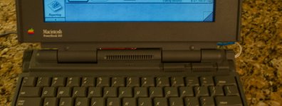

Here is my progressive repair of one of the two broken hinges on a PB 160. This is JB weld. It is a game of less than millimeters to get these to line up. It was difficult even using the remains of the shattered support. The pictures are from the first attempt. I did heap up the JB Weld, but it flattened some during the initial drying. I used a dremmel to shave away the JB weld so the hinge would fit. It was not a quick process...shave, try hinge, find resistance, shave, repeat. In the pictures with the hinge screwed on, you can see that the right post is a little off...I got a screw in, but it broke fairly promptly.
On the second try (not pictured). I coated the screw and the back of the hinge with olive oil, then, carefully keeping the oil off the post, I screwed the post onto the hinge, then put the JB weld down and pressed the hinge into place and screwed on the good side to hold it in place for drying. I was very careful with replacing the LCD, etc but so far so good. Also,the unbroken posts were shored up with some JB weld while there , but even in doing this, I had to dremmel a lot away of that JB Weld that had just been put down to get the hinge back on.

Hi, I was successful today with a PowerBook 170.
I have three of them, all with one or two broken hinge mounts.
Today I used the cover of a dead PB 145B, equipped it with the PB 170 hinges. I put little MoS2 Oil on the hinges and cleaned them. The active matrix display of PB 170 fits and now - I hope - it will live a bit longer.
