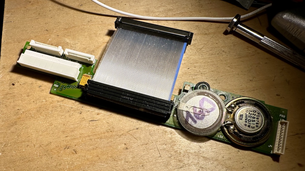

Update: swapping the daughterboard from working laptop into broken brings the screen to life.
Broken system’s daughterboard moved into working system, no display.
Issue seems to be the daughtercard. What should I check on it/what do I need to start probing to figure out what broke?
If the daughtercard is this one
Then there is high chances that the ribbon cable is broken
You can use an 80-conductor Ultra ATA cable
