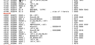

I'm getting a little further with this. I'm looking at the routine (revealingly) named CalcPCOffset. It looks like what it does is set up a Time Manager task to fire, then loops endlessly with a 60 FE BRA.S $0000 statement. Because there's now only one instruction execution could be at during interrupt time, the interrupt function actually scans through the stack looking for that instruction's memory address.
However, there's some things the interrupt function does that I don't understand, and I'm now realizing that Ghidra chokes on these instructions and disassembles them as the wrong thing (it thinks they are JSR statements that don't go anywhere), so I've been missing it this whole time. Those are:

Are you disassembling the raw library or after it has been compiled into a program? I think you are looking at the raw library, which is before all the correct addresses have been inserted by the linker. Here is what the compiled library looks like at that location.
My JSR has been linked to Anon28, right below CVTPC.
By the way, I assume the calculation interrupt routine must then change (increment by four bytes?) the found PC address on the stack, such that it can escape the endless loop after returning from the interrupt.
Yes, I have been using the raw library, and I didn't realize some of those statements would be changed after linking. Thanks for pointing that out! I would've ended up chasing my tail for quite a while otherwise. I built the example app using MPW, so I'll try disassembling that.
I believe you're correct, though it increments by two bytes. Here's what it does:

@david_cook What disassembler are you using? I'm starting to suspect that Ghidra is unreliable, in that it's not getting some of the jump instructions correctly, even when I used the linked library.
