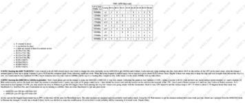

So very interesting finds. I tried to up the clock on my 6500/225 to 300MHz. The machine would boot but I would get no picture. I have since tried 250MHz and 275MHz neither of which let me get video out from the machine. I would like to point out that this has all been attempted with R207 removed. My question now is by having this resistor removed is this conflicting with higher clock speeds?
Power Macintosh 5500:6500 Clock Settings.png
Interesting. Sound like this is a easy thing to test by repopulate R207?
Yeah gonna give that a try I just find it really weird because I've done the overclock before but for some reason it is disabling video. Maybe with higher clock speed and that resistor removed it is looking for a TAM style display or video driver and not one built into the machine?
The edge connector doesn't have flat panel specific video signals, so it's at the very least still outputting RGB video to the port if it is actually outputting video at all.
The only thing that I would think of, is potentially the video sync type (perhaps the flat panel uses C-Sync instead of HV-Sync?), but I'm not certain.
That said, it could very well be that even a 25MHz push is too much for the 603ev, it might chime but it's not a sure fire sign that the system is fully booting, as the video doesn't initialize until after it chimes.
One way to check if the system is responsive, is to check if Caps/Scroll/Numlock do anything, as if the lights don't change on the keyboard, the system's likely to be hanging.
It would not surprise me if the TAM is relying on C-Sync only, so i would check if the C-Sync signal is there.

That's my 6500/225. It has 8MB RAM soldered onboard, and I currently have it overclocked to 300MHz. It also has a non-functional Rage Pro Turbo PCI chip soldered onto it and is utilizing a Radeon 7000 as main display graphics card.
I just plucked off R133 to drop the CPU from 300 to 275 and saw no change, I still see:
0 > f3000034 rl@ 8 u.r 7A1030E0 ok
That makes sense.
R133 is connected to PLL_CONFIG1 which is PLL_CFG1 of the 603ev CPU. You can access these bits in the HID1 register of the CPU.
Code:
hid1@ 8 u.r
The most significant bit is PLL_CFG0.
DingusPPC hardcodes HID1 to 0x70000000 (225MHz).
