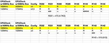

Yeah, @obsolete mentions this in their first post, switching the resistor config from x5 to x4 to not overclock the onboard 603ev on their 5400/200. On my 6360/160 I think I'll change it to x3.5, 175MHz, as 200MHz seem like it might be pushing it too far but I like the idea of trying a little 603e boost even if I'm normally using an L2 G3 upgrade card. On a 6400/180, changing to x4, 200MHz, would be similar.
CPUClock
w/40MHz Bus
CPUClock
w/50MHz Bus
ConfigR332R331R330R329R145R144R143R142Note
80MHz100MHzx2iRiiRxRR
100MHz125MHzx2.5iRRiRxxR
120MHz150MHzx3RiiixRRR
140MHz175MHzx3.5RRRixxxR
160MHz200MHzx4RiRixRxR
180MHz225MHzx4.5iRRRRxxx*
200MHz250MHzx5RiRRxRxx*
220MHz275MHzx5.5RiiRxRRx*
240MHz300MHzx6RRiRxxRx*
  • R = Resistor in place
  • x = No resistor in place
  • i = Does not matter if there is a resistor or not
NOTE: * is PowerPC 603ev (over 180MHz) only.
  • R329 = 473 (4.7KΩ)
  • R330 = 473 (4.7KΩ)
  • R331 = 473 (4.7KΩ)
  • R332 = 473 (4.7KΩ)
  • R142 = 510 (51Ω)
  • R143 = 510 (51Ω)
  • R144 = 510 (51Ω)
  • R145 = 510 (51Ω)

Finally got the time to work on this with a Performa 6360/160. Did the 50MHz clock crystal oscillator swap, and the bus speed memory timing resistor changes. Thought I'd give it a go leaving the CPU multiplier unchanged at 4x, meaning overclocking the CPU to 200MHz, it chimed but perhaps unsurprisingly I couldn't get it to boot all the way to the desktop before it would lock up.
To be really conservative (and since it was only one resistor change, an add) I backed it down to 3x, 150MHz, and it seems happy there, System Profiler, Sonnet Metronome, and Gauge Pro all show the Bus speed at 50MHz and CPU at 150MHz.
To get to the CPU multiplier resistor (R143) I needed to remove the heatsink, and ultimately redo the thermal paste so took a picture of the CPU, an IBM 603ev (PPC603evFB160r) that doesn't like a itty bitty little 25% overclock...
Going to ultimately try 3.5x, 175MHz, after I do some benchmarks.
I have to say working with 0603 resistors is kind of insane, no way I could do it without a microscope. I also got to use a new Christmas present that was extremely helpful, a SEQURE HT140 2-IN-1 Portable Hot Tweezers Soldering Iron. Used lots of Chip Quik flux too.

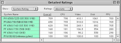

I think these Norton System Info v5 Benchmarks are pretty interesting:
All tests done in a Performa 6360/160 chassis (including with the 6500/225 board), same 64MB EDO DIMM installed on the logic boards and booted from the same Mac OS 8.6 install on a 160GB PATA HD.
My takeaways:
  1. Going from a 160MHz 603ev on a 40MHz bus to a 150MHz 603ev on a 50MHz bus is overall a wash.
  2. At the ~same CPU clock speed the main benefit of the 50MHz over 40MHz bus is video and disk performance.
    1. The benefit is there is greater if you have a G3 upgrade (20% improved video performance)
  3. The 6500/Gazelle logic board's improved graphics aren't matched by Alchemy at 50MHz (not that surprising)
What's improved makes sense looking at the system architecture diagram, faster speed communication with graphics controller and PCI bridge where the IO is located. Graphics performance shows more improvement as it has a dedicated cpu bus connection vs. hard drive performance which is shared with other I/O.
