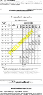

The following table shows the bus multiplier settings for the 604 and 604e. Note "PLL_CFG" 0 through to 3.

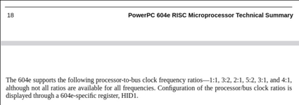

The image you posted is for a 603e. I believe the highest multiplier for the 604e is 4x. I bought a 240/60 604e card hoping to run it at 250/50, but sadly it seems the max multiplier is 4x.
I uploaded the table from the wrong datasheet sorry, I was cross referencing the 603 and 604 at the time. Here is a 604e equivalent. The multiplier table is identical where they overlap.
Not sure why your document says only 4x. Guess it was older.
The 9600/233 has a 46.6MHz bus and a 233MHz CPU, so 5x multiplier. That is what my second photo of resistors shows.
Note the clock and CPU speeds, plus the multiplier of 1011. This is a 604e (i.e. not a 604ev). This is the fastest variant before apple switched to the 604ev with the 250MHz 8600 and 9600, which used a revised logic board, I believe for increased power delivery to the CPU card.
