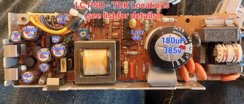

Here's my minor contribution to this thread which I found really useful! Thanks to @SuperSVGA!
Here's two corrections to the schematic. As discussed previously, the pin numbers for IC51 (C78N05) were incorrect. The labels are correct for the pin numbers which were flipped. Also found pin labels for the 17431 (IC54) has labels swapped for pins 2 and 3.
I'm also kinda confused by wiring for the 7805 instead of a 7905 but I guess it's fine because this basically just moves ground 5V lower and the output being 5V higher at ground internally it's doing its job. I expect I'll never find a use for that trick!

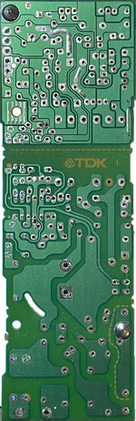

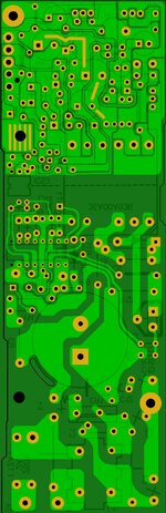

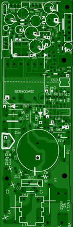

Hello,
Attached image is looking at the underside of the board (the solder side) with the input on the left and output on the right.
Measuring the output of the transformer is a bit tricky because it will be "pulsing".
And I would imagine that the frequency and hence voltage would be a bit different depending on load and feedback circuit and adjustment and what not.
Ben

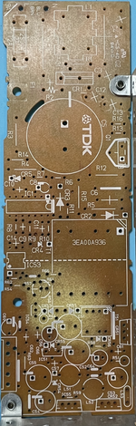

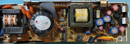

I just wanted to say thanks for this awesome thread and the very useful pictures! I recently bought a Mac LC with a TDK 699-0153 PSU. The logic board caps had leaked, but that repair was straightforward. The PSU gave me fits though. The capacitors on the low voltage side of the board had leaked extremely badly, especially the ones that weren't Nichicon originally. The bottom of the PCB was black underneath them.

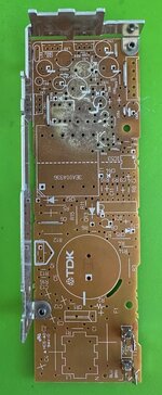

After removing all the caps on that side of the board, cleaning everything I could with isopropyl alcohol, and then reinstalling replacements, it still didn't work. The -5V rail was fine, but the 5V and 12V rails were producing voltages that were too low. I didn't write the exact voltages down but they were way too low. Something like 4.4 volts and 11 volts.
I noticed that the solder joints on the nearby components looked really dull and ugly, so I reflowed them with fresh solder, and that improved things a little bit. The 5V rail's voltage went up a little (still too low though -- it would just chime repeatedly when I powered it on).
The leakage had been really really bad, so I decided to take drastic measures and depopulate almost everything on that side of the board. This ended up being a smart move because there was still leaked cap goo all over the place under nearby components. Here you can see all the extra gunk that I missed the first time.
Removing everything allowed me to thoroughly clean the board as well as each individual component. Plus it gave me a chance to pull out all of the original solder that had clearly been contaminated by the electrolyte. I put each part into its own individual labeled tiny bag so that I knew which one was which.
I also noticed a few places on the copper where there was dark staining from the leakage under the solder mask, so I scraped the copper until it was gone and then covered everything back up with some UV solder mask. It looks a little messy, but hey, it does the job. Here's the solder mask repair before I started replacing everything. There might be a few ugly solder whiskers here and there that I fixed before putting it all back together.
After soldering everything back into place, now it's great. Without the original hard drive plugged in, I get 5.1V, 11.92V, and -5.04V. With the hard drive plugged in, the 12V rail dips down a bit to 11.76V but it still seems to work fine. I'm definitely happy!
TL;DR: if the caps have leaked enough, you really need to clean everywhere in the vicinity. Not just underneath where the capacitors were.

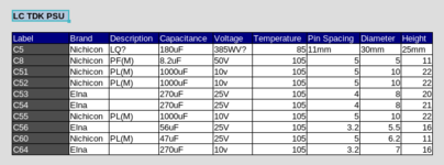

Thanks for all of the fantastic information in this thread. I am preparing to recap a faulty TDK 699-0153, but in addition to new caps, it also seems L52 has failed. Does anyone know the exact specs on that inductor? I am finding a wide range of 4.7uH inductors on Mouser, with various current ratings and very different price points.
Thanks!
Got a bad power supply I'm trying to repair with 5V/-5V/12V all low and unstable.
Electrolytic caps were all leaking so I've replaced all of them. Cleaned the PCB up and it's spotless now. Have also tested all diodes, FETs, voltage regulator and and they are all good.
-5V:
5V:
12V:
Anyone seem something like this before and can point me in the right direction.
PCB looks good. No corroded tracks, no shorts, solder all looks good.
Been trying to repair a power supply that had me stumped for weeks. Replaced all the caps and was still having issues with very unstable voltages. The M51996P keeps restarting.
After reading through the datasheet it looks like it's just a bad design. They are missing a cap across Vcc which is recommended in the datasheet for help with unstable startups. I think the original design was right on the edge and maybe they got away with it. When components start going out of spec it's causing issues - at least in my case.
On M51996P I added a 10uF cap across Vcc-GND which fixed the startup issues. PSU has been running fine ever since.
Maybe this will help someone else out, or a future me when I'm repairing another PSU in a few years time and having the same issue.
I have been working on two of these supplies lately that would not reliably start from cold. While there is actually a reasonable filter capacitor on M51996P Vcc (C8), I suspect the resistor divider providing the kick start voltage is operating with too little margin. The M51996P startup voltage is 15.2-17.2V according to the datasheet, typically 16.2V, and the supplies I had issues with only reached around 15.5-15.7V at 240VAC in which was not enough.
Increasing value of R7 until kick start Vcc reached 16.2V made startup reliable.
