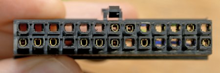

The output wires of my Seasonic SSP-250SUB PSU:
Yellow: +12V (I used 1 wire from pin-2 and 1 wire from pin-3)
Orange: +3.3V (I removed all these from the black connector)
Red: +5V (I used 1 wire from pin-9 and the 1 wire from pin-21)
Purple: +5V (I removed all this from the black connector)
Gray: +5V (I removed this from the black connector)
Blue: -12V (I used this from pin-13)
Black: (-) Ground (I used pin-1, pin-5, 2 wires in pin-6 & pin7 -- total of 5 ground wires).
Green: Pin-25, which I connected to pin-20 that was previously GND.  (Shorted to (-) Ground for the PSU to operate.)

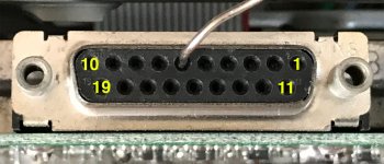

Now note the external floppy connector pin numbers:
With my meter's ground probe connected to a ground point on the back of the analog board, and measuring at the solder side (back side) of the analog board, with SEASONIC as my PSU, I see this:
Pins 10 & 6 (top row) and 15, 16, 17 & 18 (bottom row)= 4.89V, with Ground Probe on analog board solder side GND or on metal chassis where GREEN wire from PSU screws onto it)
Pins 7 & 8 (top row) = 12.33V, with Ground Probe on same point(s) as the 4.89V measurement above.
So I am not getting that amazing 4.97V at the floppy connector like you, but 4.89V is certainly better than the 4.7V I was measuring before with my lackluster ground.  And again, measuring both Positive & Negative at the solder side of the Analog Board shows 5.07V, and I get 5.13V from the SEASONIC open-circuit.
