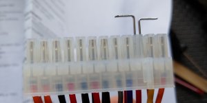

I started by pulling wires from ATX connector using the staple trick to get the molex pin out:
All pins were removed with this method so I didn't need to crimp any new pins.

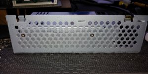

After getting the dead PSU out, the Seasonic would fit just fine inside the PSU chassis so I tried to figure out how to secure it. First I tried using screws from the Seasonic through existing holes in the chassis:
I tired to do this project without any new holes in the chassis and this didn't allow me to power it the way I planned by bringing a standard 3-prong power cable inside from the switch:
The existing holes were either too far forward for the power cord to do a 180 towards the switch or too far back such that it wouldn't allow the chassis to close.

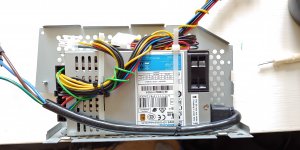

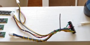

I think I went the same route as superjer2000 with all of the wires:
Normally, this style of power supply is operated by soft-power.  A momentary switch on the computer case issues a latch which the motherboard places on the PS-ON pin of the power supply.  Our SE/30 does not have the circuitry to do this, so we need to force the power supply to be on when the switch is on.  We do this by shorting the PS-ON pin (green wire) to GND (black wire).  After placing the small shunt, the power supply will turn on fully as soon as the power switch is flipped on.
To handle PS-ON, I just grounded this on on of the unused ground wires coming off of the PSU (black plug on the right above). The stock SE/30 plug is bottom left, the longer +12v yellow with extra wraps is used for sweep...it came from that 4-pin (2 YW & 2 BK) plug that I left attached. These yellow wires are joined at the connection to the PSU.  Same goes for the yellow wire to the hard drive plug...it is shared with the other +12v.
So here is a look at the wire loom packed into the chassis:

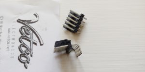

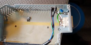

To make the connection to the power cord, I went to the local Vetco and got some of these doodads:
The stock connection from the switch to the original PSU uses a 4-pin with of this type with only 2 outer pins.  I soldered power cords hot and neutral to this and then a round termination for ground:

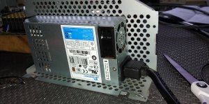

I closed up the chassis and tested voltages and all seemed good.
Both +12v were at 12.03
Both + 5v were at 5.13
The -12v was 11.98 which seemed close enough...
With this I installed it in the case and promptly attached the PSU plug to the motherboard plug.  After getting that set straight I crossed my fingers, made a few offerings to Ullr, I turned the power on.  I got happy chime then chime of death.  I scratched my head after I walked away for a bit and then realized last I was using this motherboard I was testing RAM and it had bonked because I had 4 1MBs in front and 4 16MBs in back.  I then swapped out to my SE/30 board that will soon be recapped and tried it. While it gave no chime, it did boot...yay!  I then realized the cursor would not move. Ooops...I forgot to plug in the ADB.  After trying again, the machine booted and worked as expected.  I will play around with this more tomorrow after some sleep.
