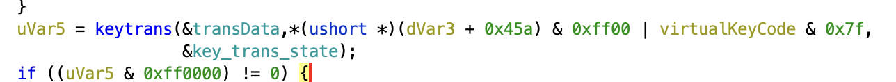

The routine that turns keycodes into characters is called _KeyTrans. I'm working from the MacOS version of this because it's easier to read, but it looks like the A/UX version uses the same flavour of resource.
KeyTrans uses a KCHR resource, which manages a set of mappings from key code to character. In systypes.r it is defined thusly:

We should be able to reverse this mapping and get information back about the key codes we need to send (rewritten by the kmap). I was a bit worried because this is a variable length resource, and we need to copy it out of kernel space into user space. However! On closer looking at the UI_keyboard code, it in fact always uses the same keytransData buffer for the KCHR:
and the uinter ioctl that imports the KCHR actually copies it into this buffer. This buffer is statically sized at 3k: so we can use a similar trick to the clut and smuggle it out in chunks. (It might be better to have this as its own device node, same as the clut, but that would make the driver more complicated. Maybe a later thing). So this will be the next trick.
The "let's reverse the KCHR" trick works! With a bit of mucking about, we can turn a character back into a sequence of keycodes (including dead keys!) With a bit more mucking about, and this was very tedious, we can convert X keysyms to MacRoman characters. By doing it like this, the resulting VNC server should give the right results regardless of the keyboard layout in play on the server: so people who are using non-UK keyboards won't be stuck with my defaults any more. For the moment we're still stuck in MacRoman, though.
