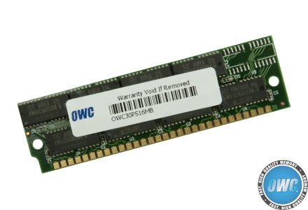

I’ve had good luck with other world computing‘s 16mb kit and it seems cheaper too. I just ordered 8 more 16 mb simms.
Yeah and it looks like they also ship to the UK. Total price for 8x16MB SIMMs shipped to the UK is $103.58 compared to $137.72 for Keystron. That's a decent saving.
I can't quite make out the chip part number but there are certainly 8 of them instead of 2 with the Keystron module. I wonder if these are 3.3V or 5V. And just look at that "Warranty Void If Removed" sticker. 😅
