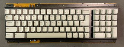

Do any of you own a Mac Plus extended keyboard with numeric keypad? Could you please confirm the capacitance & voltage ratings of axial capacitors C1 & C3 shown in the photo below?  I think there are only those 2 electrolytic capacitors, but if there are more, please ket me know that too.  Also, if you have calipers, could you measure the distance between the PCB and the bottom of the metal frame so I know the maximum diameter of replacement axial capacitors?

Another photo I found below indicates there are two different versions of the Mac Plus extended keyboard.  I see 2 Radial caps in that photo below, whereas there are 2 Axial caps in the photo in my opening post.

I'm not very knowledgeable about capacitors, but here are some photos of my boards if it will be helpful (I also have one more that I can't find at the moment). One of mine is a Japanese board and one is American. I don't see anything else that looks like a capacitor to me.
Thank you for the clear photos!  I now have 2 questions:
Q1: Does the right side (not shown in your photo) of capacitor C1 say "50v 1µF"?
Q2: Do you have calipers or another means of measuring the distance between the top of that circuit board (onto which the capacitors are soldered), and the bottom of the black metal frame?  (The reason I ask is so I can know the maximum diameter of the replacement Axial lead capacitors.)
Yes.
It looks to be slightly over 7mm (the curve of the metal frame makes it difficult to be exact).

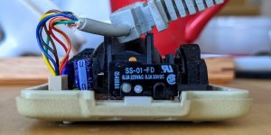

@Mighty Jabba Bless you for more excellent photos!  The height and diameter of those radial 1uF 50V caps seems to be right at the limit of what can be installed, which means any replacements need to be considered with care.  Am I correct in assuming a replacement cap could be up to 8mm in height and 6.5mm in diameter and still fit?
They appear to be 47µF 6.3V capacitors:
I don’t have a good tool for measuring size, but from the profile, the height appears to be slightly more than the switch box and slightly less than the switch button. I think the case leaves them some good clearance too.
@sfiera A thousand thanks for the detailed photos of your mouse!  Did that come with a Macintosh Plus?  Also, can you measure the DIAMETER of those caps?  (D=6.3mm & L=11mm?)  The one nearest the connector in your photo seems the most critical in that any replacement cap with a bigger diameter would not fit there.

It has a M812M0100… (1988) serial number, so it was probably a Plus mouse, but I don’t know if I can say that with confidence. Your mouse matches a G447M0100… that I have. I saw another, seemingly older mouse (no chip) on the forums as well.
By the way, here’s the underside. There are a lot more components, not just on the top:

Can you please measure the DIAMETER & LENGTH of your 47uF 63V caps?  (D=6.3mm & L=11mm?)  The one nearest the connector in your photo seems the most critical in that any replacement cap with a bigger diameter would not fit there.
True, there are components on the bottom of that PCB, but there is no space to fit a fluid filled electrolytic capacitor there, which is all we are concerned about.  Again, I am quite curious why they added those caps in later editions of the original design mouse seeing older models work fine.  Hmmm....
