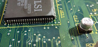

For the most post, their recap was fine. The large electrolytic capacitors were soldered well to the top of the board. But, they missed a few places underneath -- but I don't think this prevented the board from working.

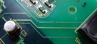

1. After ultrasonic cleaning, I inspected the trace that goes from the ADB power key, to the power switch, and then all the way back to UB1 and UB2 for the power circuit. On the Macintosh II and IIx, this line is always broken somewhere, because the line is energized by the batteries while sitting in capacitor juice.
There were three completely broken spots on the trace that needed to be replaced by buss wire, plus a few more spots that I scraped and tinned just in case.

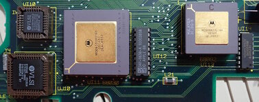

2. The board was missing the ROM. This was a bummer, because it wasn't described in the listing and no pictures showed that location on the board. No big deal. I had a spare ROM from a board with upgraded memory and 32-clean ROM. Nevertheless, if the previous owner had forgotten to reinstall the ROM during testing, they would not have gotten it running.

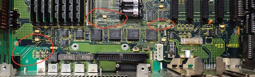

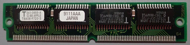

The Macintosh II board needed a lot more love. This was sort of tossed in as an extra, so it wasn't expected to be complete. As listed and pictured, it was missing a CPU, FPU, and memory. All the capacitors needed to be recapped and batteries needed replacing (and socketing).
As usual, the power switch trace was corroded broken in multiple locations.
Hey! Notice fuse F2 on the left side of the above picture? I guess the Macintosh II and IIx had non-resettable fuses for ADB. That explains why Apple warned people to not connect and disconnect ADB devices with power on -- or they could damage the Macintosh. A blown fuse would need servicing.

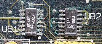

The second issue with my Macintosh II board was also really common. UB1 and UB2 get corroded due to capacitor juice and battery power.
Pictured below, can you guess the extent of the damage?

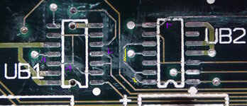

Below, the chips are removed and the corrosion is scraped off. A pin from the UB1 chip fell of prior to chip removal. The multimeter detected four complete breaks and a questionable trace.

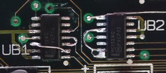

Neither chip is trustworthy. Since they are still available off the shelf, they have both been replaced with fresh chips. The broken traces have been mended with plain buss wire.
The Macintosh II lives again.

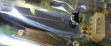

I was also interested in determining the date this board was manufactured. The box has many dates, because at some point it was reshipped. The 'Sealed Air' bag has a December 1991 date. This is a year after the IIx was discontinued. I feel like the remaining boards might have just been repackaged and sealed by AppleService at this later date.
One frustration is that Apple did not supply the power-on button cap (see below). Why? This was also missing from the IIx at the beginning of the thread. Maybe the plastic cap was added to the boards when the computer was assembled, much like floppy drive and SCSI cables? So, it simply isn't a 'part' of the motherboard.
The 'sealed' bag became unsealed at some point due to a tear in the SCSI connector locking tab. As we will see, this might have actually saved the board from trapped capacitor juice gases.

Corrosion on the power button trace exists, but is far cleaner than any other IIx boards I've seen.

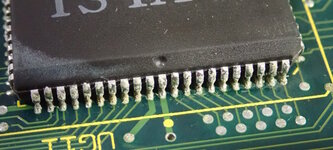

Ouch. UG1 has some encrusted pins.
It looks like C12 is to blame.
I conclude that old-enough AppleService sealed boards are still likely to be corroded. The extent of the damage may depend on storage temperature/humidity, as well as whether the air seal has been punctured. I can't decide if the board is more likely to be harmed by retaining the capacitor gases or due to exposure to outside air.
Lastly, the ROM supplied is newer looking, but contains the standard IIx 32-bit dirty image. Even though they had 32-bit clean ROMs at this point, I guess it wasn't worth the trouble to test it on a IIx and update the IIx boards they had in the service department.
