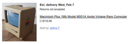

Oh in other news i ordered another macintosh off of ebay incase this one didn't work. i was actually pretty convinced it wouldn't based on all the help my tech buddies were giving me with it.
Huzzah. the new one works. It had a broken floppy drive and a broken back cover that was cracked to crap (Made worse by shipping i'm positive). Unfortunately i probably only caused more damage to the cover taking it off. but i replaced it with the old one. replaced the drive. cleaned it up a bit and it works! Now am just waiting on the SCSIdrive Ziggy made to arrive... been in Chicago for 8 days now .-.
